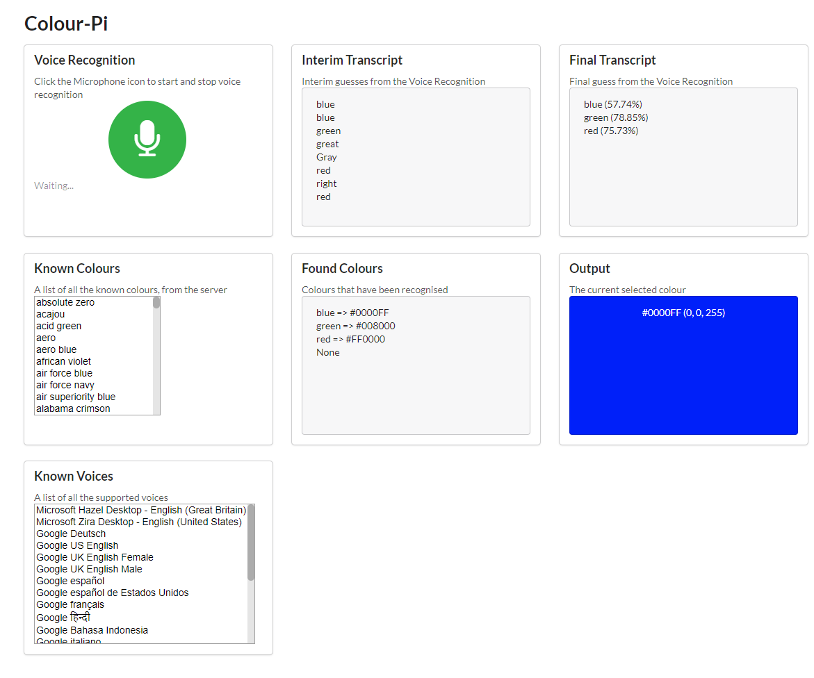

When you hit the website you should see something like this.
If you see a security warning this is because we are using a self-signed SSL certificate. You can ignore it or add it as an exception.
On selecting a file name, the source for the HTML 5 audio element. will be set to that file. Once ready, the music will begin to play. Once the song has finished the music will stop.
If you select the None option, the music will stop playing.
