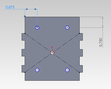

Holes will need to be drilled in the leg pieces, neck pieces, head pieces, body side panels, and ear pieces. Take a look at the dimensioned drawings on this step for measurements of the desired hole locations. The laser cut pieces will ship with an adhesive paper backing. Do not remove this paper until all the holes are drilled because you can draw marks on the paper in order to locate the holes without messing up the wood.

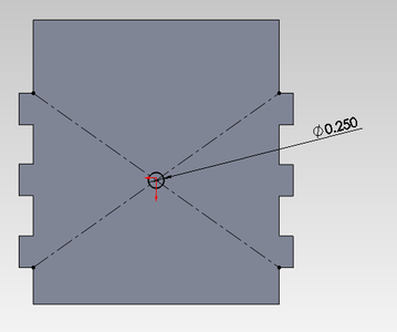

The light bulb will be mounted on the inside of the Doggy Lamp's head. Therefore, the electrical cord to the light bulb will have to have a place to go. Drill a hole in the head back piece in the center of the tabs. This hole should be just wide enough for the cord to fit through.

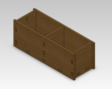

The body of the Doggy Lamp can be used to store office supplies, like pencils, markers, scissors, index cards, or practically any small object. The office supply compartment is divided in half by a MDF piece. Simply slide the single tab on the bottom of the middle divider into the hole in the bottom piece.

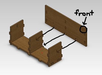

The next step is to attach the pieces that will form the front and back of the Doggy Lamp's body. It does not matter which piece you attach to which side of the bottom piece, but just note that the piece that has a hole near the top is the back (the tail will eventually be attached at that hole).

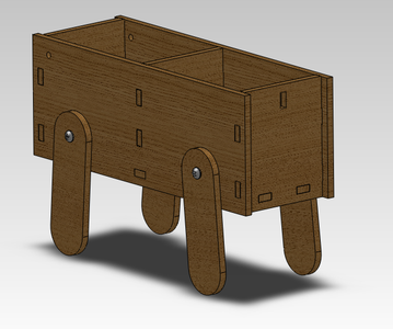

Step 8: Attach the Legs
For this step you will need the four legs, four of the bolts, and four of the nuts. Attach the four legs to the four lower holes in the side panels with the bolts and nuts. You can pose the legs by adjusting the wing nuts.
