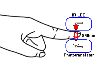

A plethysmogram is a graph of blood volume vs time and a photoplethysmogram (PPG) uses light to measure blood volume, often with a finger probe.
You can buy a pulse oximeter very cheaply on eBay. It uses photoplethysmography to measure your heart-rate. By comparing the absorption of IR versus red light, it can also measure blood oxygen saturation. It's straightforward to build a PPG that measures red and IR absorption but calibrating it is a problem. The PPG described here only uses IR light.

Step 1: What Does a Photoplethysmogram Show?
A PPG wave has a fast rise and a slow decline. During the decline there is a second peak. The first peak is the "systolic peak" and the second peak is the "diastolic peak". The dip between the two peaks is the "dicrotic notch".
The systolic peak is due to the pulse of blood arriving from the heart after systole (when the ventricles contract). The diastolic peak is due to reflection of that pulse from other parts of the arterial system. There is a reflection from anywhere there's a sharp change in impedance. The major reflection is from the junction of the aorta and the iliac arteries. There are others from earlier junctions but they tend to get hidden in the systolic peak of the PPG.
The size of the diastolic peak varies with where on the body you measure the PPG. It is quite large on the forehead and almost disappears at the toes.
The size of the diastolic peak also varies with age. It is quite large for young people and becomes smaller with age. The dicrotic notch is also large for young people and becomes smaller with age.

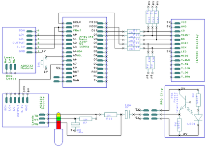

Step 2: AD8232 Circuit
Skip to the next Step if you are building your own amplifier.
The AD8232 chip contains a high quality, low noise instrumentation amplifier and signal conditioning to remove noise. It is intended primarily for recording ECG but it works very well to record a PPG signal.
Buy a module like the one in the photo. Search eBay for "AD8232 module" or "ecg module". You don't need one with leads and electrode pads. You should already have a similar module measuring ECG.
R8 and LED1 produce infra-red light which passes through your finger to PD1. The current through PD1 produces a voltage across R1. That voltage is AC-coupled to the RA and LA inputs of the AD8232 module. The RA and LA inputs of the AD8232 module are connected to the RL (driven ground) output of the AD8232 through 1M resistors. That keeps the voltages at RL and RA in the correct range.
You can connect the PPG circuit to the AD8232 module using a 3.5mm jack plug or just solder the wires into the holes in the AD8232 PCB.
I suggest that you build the circuit on stripboard - it has very few components.
The value of R6 determines how large is the PPG signal. Try values between 100R and 470R.
The module produces mains hum when you connect the circuit to a computer with a USB lead. The hum goes away when the unit is disconnected.

Step 6: ECG Unit Hardware
This plethysmogram is an add-on to my ECG project. The output from the PPG is connected to the A4 analogue input of the Arduino.
I decided to use a 3-pin 0.1" Molex connector. A stereo jack would look nicer but the AD8232 module of the ECG already uses a 3.5mm jack. It's important that the two connectors cannot be confused: you don't want to connect the 5V supply to the ECG electrodes attached to your body. A 2.5mm stereo jack would be better than a 0.1" Molex but I didn't have a 2.5mm plug/socket to hand.
You can see how I have fitted the PPG socket into the (rather crowded) ECG case. No doubt, your layout will be different.
If you you have built your own amplifier: The three wires connect to 0V, 5V and A4 of the Arduino Nano.
If you are using an AD8232 module: The phototransistor, LED, R6 and R8 can be assembled inside the PPG clip. The R7, R11, C7 and C8 can be soldered onto a small piece of strip-board inside the case of your ECG.

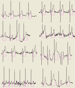

QT interval is a useful measurement in predicting ventricular arrhythmias. "Long QT syndrome" can be congenital or due to various medications or drugs.
It is hard to automate the calculation and many doctors don't trust automated systems. There are lots of different attempts at algorithms which implies to me that the problem has not been "solved". The result you get can depend on where you've placed the leads.
The QT interval is defined to be the time from the start of the Q-wave to the end of the T-wave. The start of the Q-wave is the time at which the ECG signal starts to dip just before the large R spike. The end of the T-wave is where a line drawn through the falling part of the T-wave meets the baseline. In textbooks, it looks easy.
In the real world it's much harder. There is noise in the signal. Where is the "baseline"? What is the slope of the T-wave? Where do you measure it?
The rest of this Step describes my solution. You can skip it unless you're interested in the maths.
The start of the Q-wave is easy. It's the sample after the last time the differential of the signal was positive before the R spike. You have to smooth the signal to remove the worst noise. I say that the Q-wave is easy because the Q-wave is so quick that any mistake you make will only affect the estimated QT-interval by a few milliSeconds.
The T-wave is harder because it's slower and more vague. The algorithm I've developed for finding the end of the T-wave is as follows.
The ECG signal is differentiated and smoothed. The peak of the R-wave corresponds with the biggest value of the differentiated ECG signal.
The peak of the T-wave is located. It is the highest value of the ECG signal that is between 200mS and 500mS after the R-wave.
Once the peak of the T-wave is found, the program calculates the regression line of the signal from the peak to 100mS after the peak. The program starts collecting:

The end of the T-wave is where the line crosses the "baseline" but where is the baseline?
The ECG signal is exponentially smoothed. When each sample arrives, it is smoothed using
smoothed_sample = smoothed_sample*alpha + sample*(1-alpha);
Alpha ought to be calculated as
alpha = exp(-1/Tau);
but it can be approximated more cheaply as
alpha = 1 - 1/Tau;
The bigger Tau (the time-constant) the more the signal is smoothed; i.e. the more slowly the smoothed signal changes.
The estimated baseline is an exponentially smoothed copy of the signal. The time-constant of the exponential is longer when the signal is further from the current estimated baseline:
- "sample" is latest sample
- diff is (first derivative of sample)²
- ds is diff smoothed with time_const=20mS
- Tau = 2*(ds+sqr(sample-baseline)+1)
The baseline is "sample" (the latest sample) smoothed using a time-constant of Tau. So the baseline changes slowly due to big sudden changes (like the R-wave and T-wave) but stays close to (what a human thinks is) the true baseline.
The "first derivative of sample" is, in fact, sample[i]-sample[i-n]. Where n is chosen to be around 20mS before. (The larger the value of "n", the more the differential is smoothed.)
I admit, a lot of the algorithm is rather arbitrary but it works at least as well as other algorithms you can find in scientific papers. The images above show the results when applied to a database of typical "real world" recordings that contain all sorts of errors.

pinMode(A4,INPUT_PULLUP)
So that if the PPG clip is disconnected then the input is pulled up to 5V. The sketch recognises that the the PPG signal is high and doesn't display it.
With the AD8232 module, that "pullup" trick doesn't work - the AD8232 always produces an output in the right range. However, when the PPG clip is disconnected from the AD8232 module, the module produces a lot of noise. So as an additional test, the sketch looks at the total "energy" (the total changes across the sweep). If the "energy" is greater than a threshold then the next sweep of the screen is not displayed.
