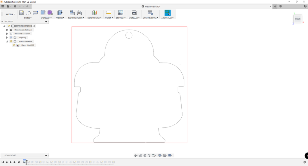

The procedure with Autodesk Fusion360
Step 1:
I attached the MakeyOutline as a Canvas to Fusion. At this moment I ignored the scaling, but I fixed it in a further step.
Step 2:
With the Spline tool, I traced the outline and created the main shape as a sketch.

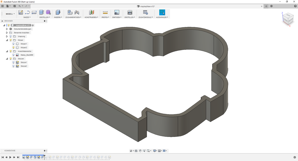

I scaled it to its final shape. The reference point was the foot of Makey with a length of 44.8 mm. After that, I created two offsets. The first 0.5mm around the PCB to give it some space to "breathe" and the second with an offset of 2mm as the outer contour. This results in a 1.5mm thickness of the enclosure.
Step 5:
With the help of a caliper, I measured the thickness of the soldered PCB. 11.5mm. For that reason, I extruded the sketch to 12mm.

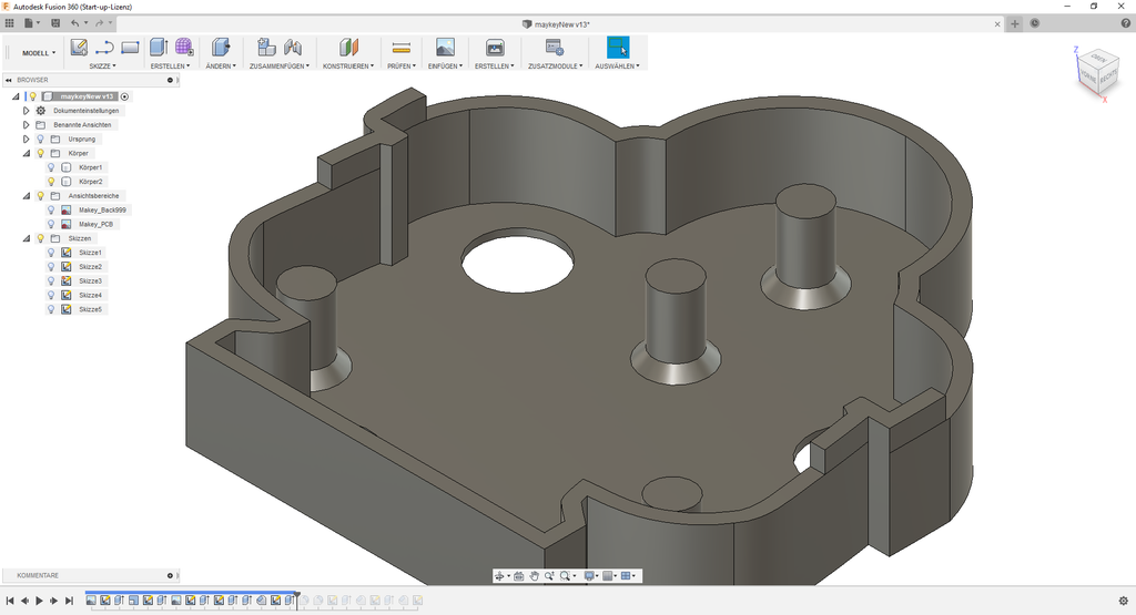

On the back of the shape, I created a 1mm thick bottom.
Step 8:
With the help of the MakeyBack Canvas, I sketched three recesses (two for the poti, one for the on/off switch) and four pillars to the enclosure bottom.
Diameter
- Recesses 11mm
- Pillars 6mm
Step 9:
I extruded the pillars to 10mm and deleted the three recesses. To stabilize the pillars, I added a 1.5mm Fillet to the bottom.
