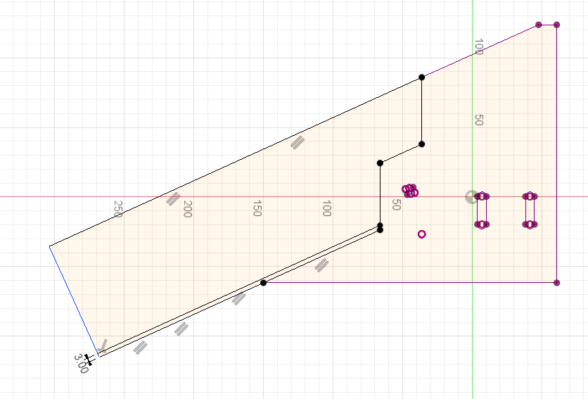

The procedure with Autodesk Fusion360

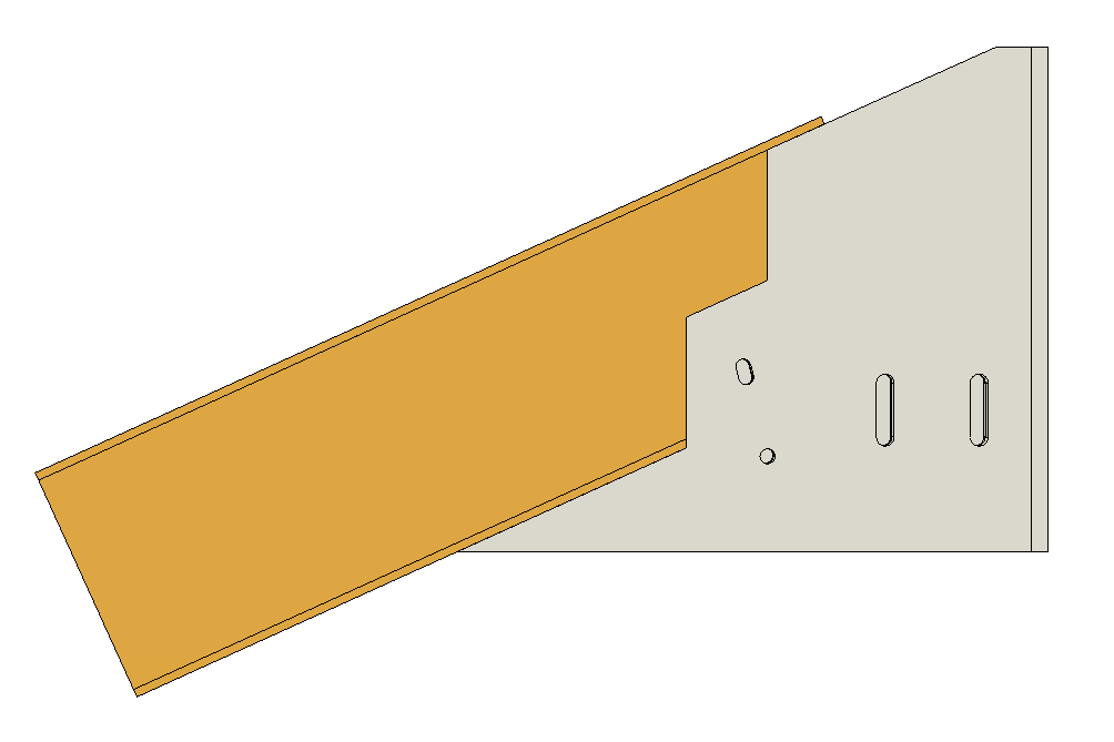

I have projected the contour of the Feeder into a new drawing. Based on this, I have created a sketch for the Scanner. It's the side view of one of the side walls.
I extruded this side wall sketch to 3mm (thickness of the cardboard). After that, I copied it and moved it 83.5mm away. Thus I had two side walls.
To create the top of the Scanner, I sketched a simple rectangle on top of the side walls. In the same way, I created the bottom.
That's the main shape of the Card Scanner.

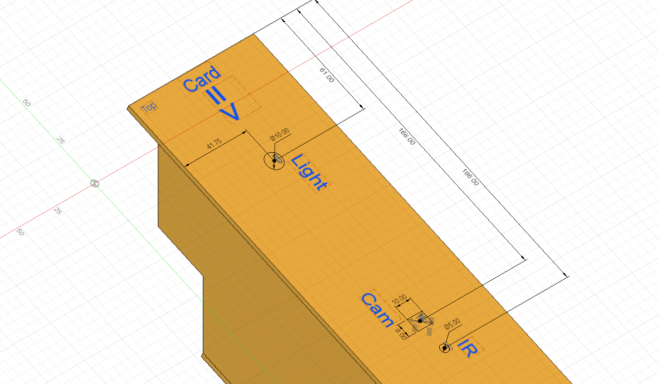

In a further step, I added the positions of the components.
On the bottom:
  • Servo Motor (Stops a card so that it can be photographed)
  • IR Break Beam (Is not needed for the Scanner, only in the interaction with the whole Trading Card Machine)
The same thing is necessary on top of the Card Scanner.
There it is:
  • LED light (Creates the right light for the camera)
  • PI Camera (Creates photos of the cards so that they can be analyzed)
  • IR Break Beam (Is not needed for the scanner, only in the interaction of the whole Trading Card Machine)
This is the draft shape of the Card Scanner

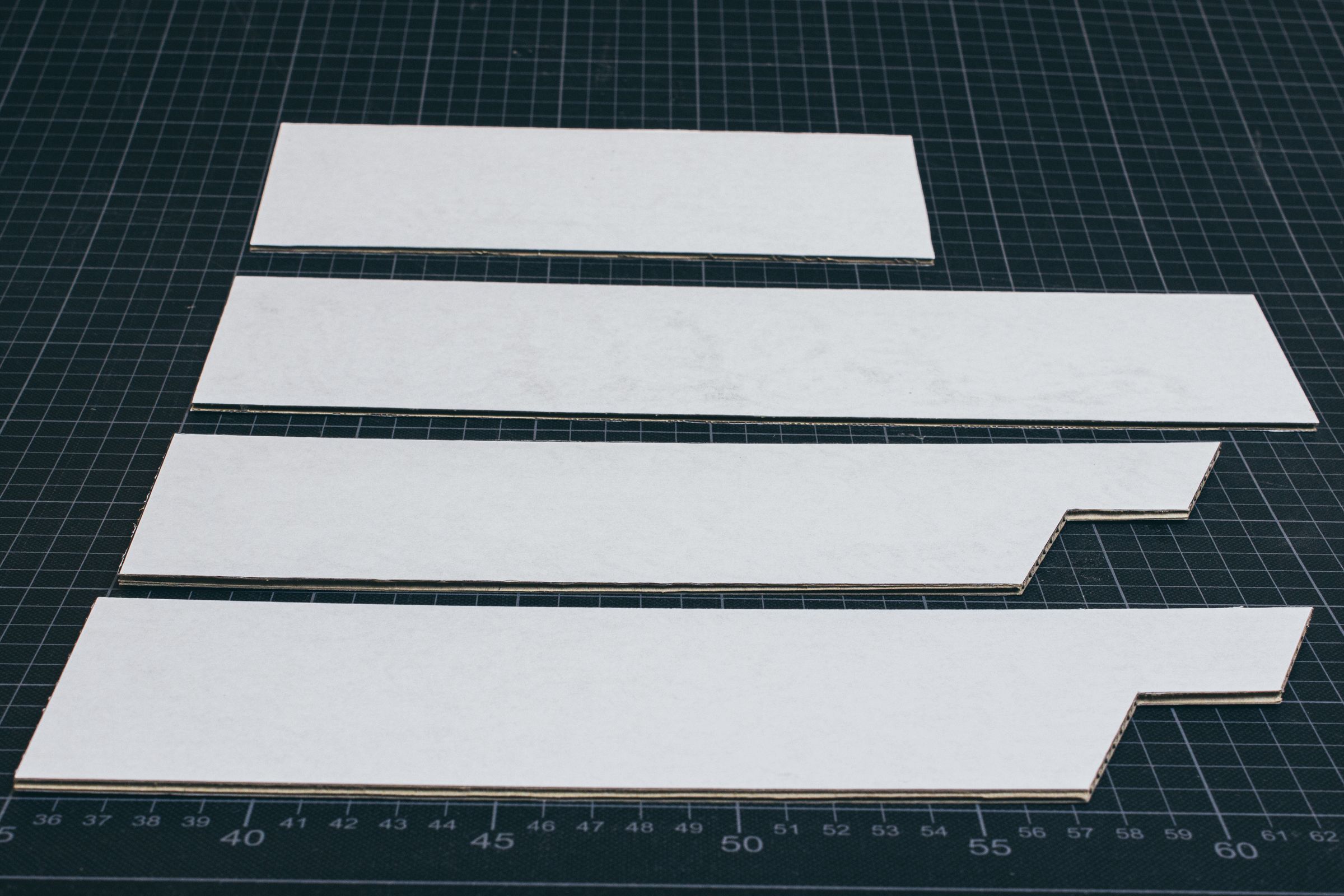

I printed the two side walls that were created in the Design Step on a DIN A3 sheet.
I roughly cut these out with a cutter. With TESA adhesive I glued these two shapes on 3mm cardboard. It is important and necessary to apply glue and paper on both sides as otherwise, the cardboard will bend during the drying phase. With that said, I glued some piece of paper to the backside.
While the glue was drying, I cut out an 83.5mm wide strip of cardboard. From this strip, I cut a 222mm and a 323mm wide piece. This is the top and bottom of the Scanner. To create the same look, I applied glue and some white paper to both sides.
After everything was dry, I cut out the final shapes.
2x side walls, 1 top and 1x bottom

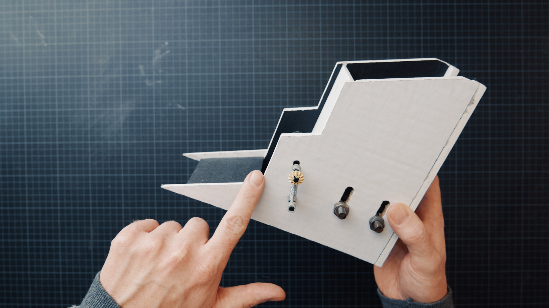

After everything was prepared, I started to mount the components.
On the bottom I used a Hot glue gun to mount the IR and the servo. It is not possible to use screws or nails, because they will protrude into the Card Scanner.
On the top of the Scanner I used very small screws and nuts to mount the IR, PI-Cam and the Raspberry PI. The LED light was only plugged into the cardboard.
I don't want to glue the top piece to the rest of the Scanner. In case of problems (card jam), I want to be able to intervene.
To stabilize the whole Card Scanner, I glued three cardboard strips to the upper area of the side walls. With 3 nails I can fix the top temporarily to these strips.

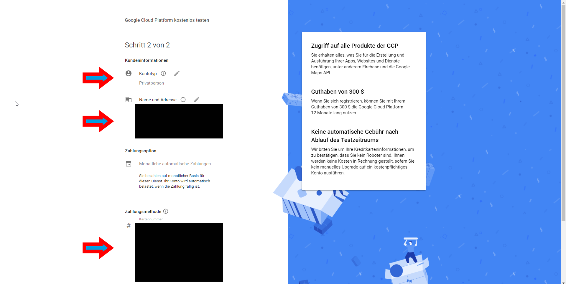

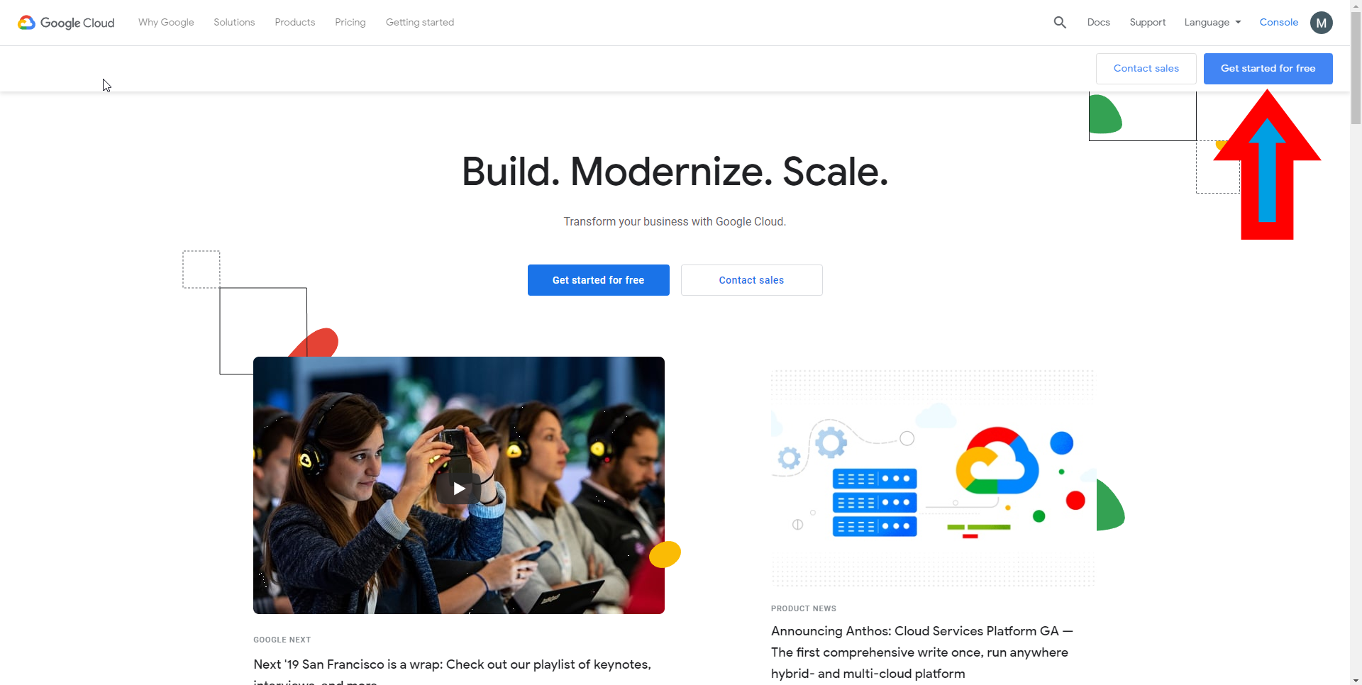

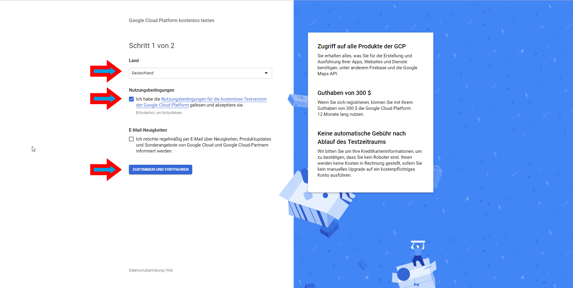

  • Create a Google Cloud Account (I had already a Google Account, otherwise you need a Google Account too)

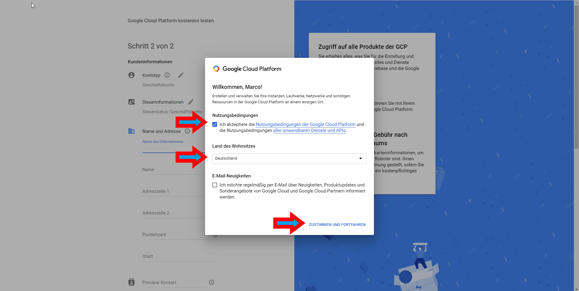

  1. Choose a country
  2. Accept Terms & Conditions (Sorry for the German screenshot, but I couldn't switch it to English)
  • A Popup appears asking for the same information. Why? I don't know, but choose a country, accept Terms & Conditions and move on
  1. Choose account type "private"
  2. Type in your name, address and
  3. your credit card information

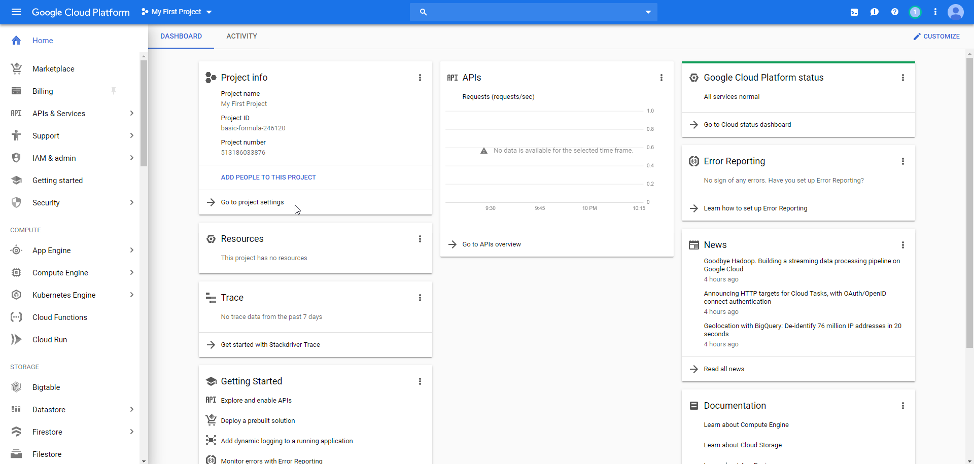

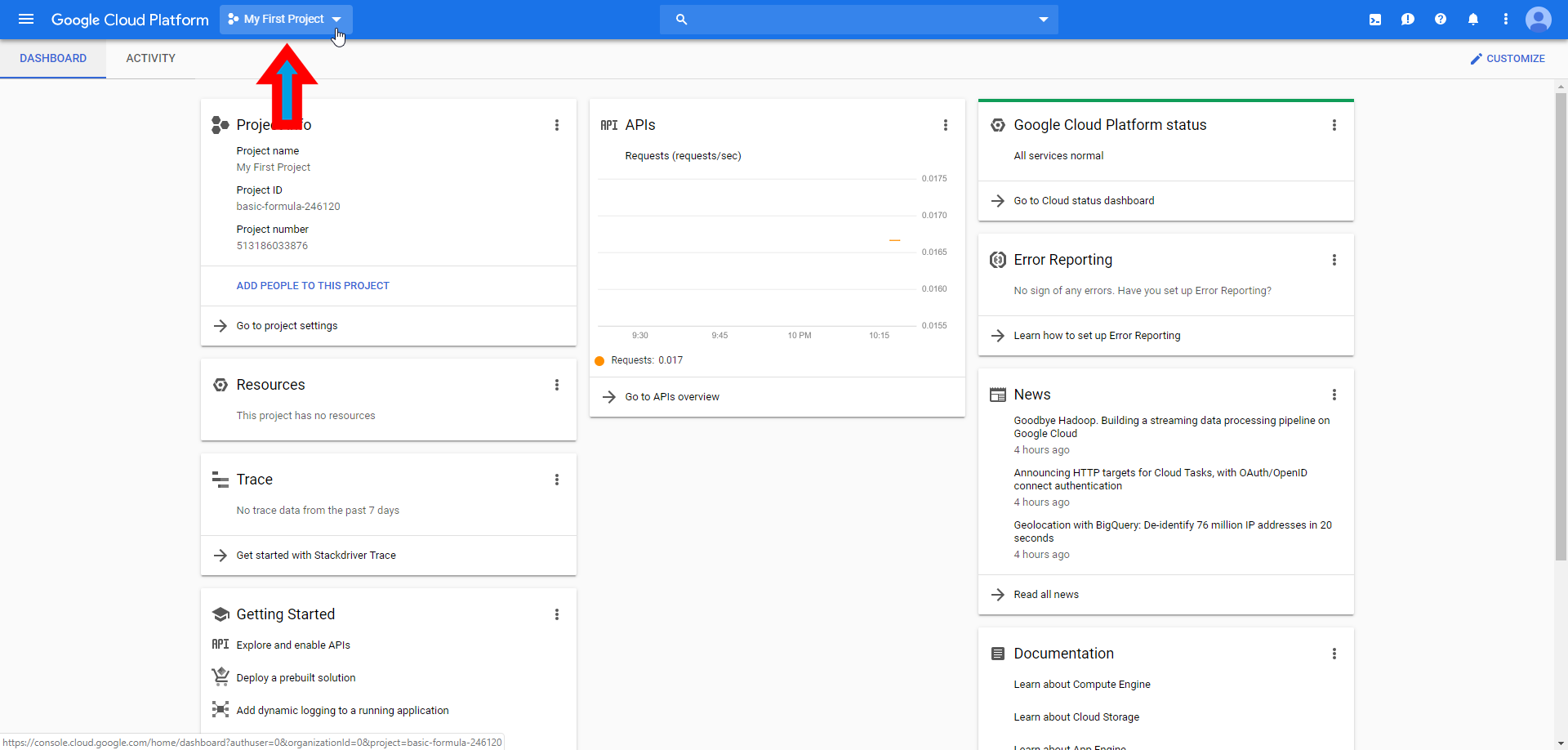

  • Home screen of Google Cloud Platform

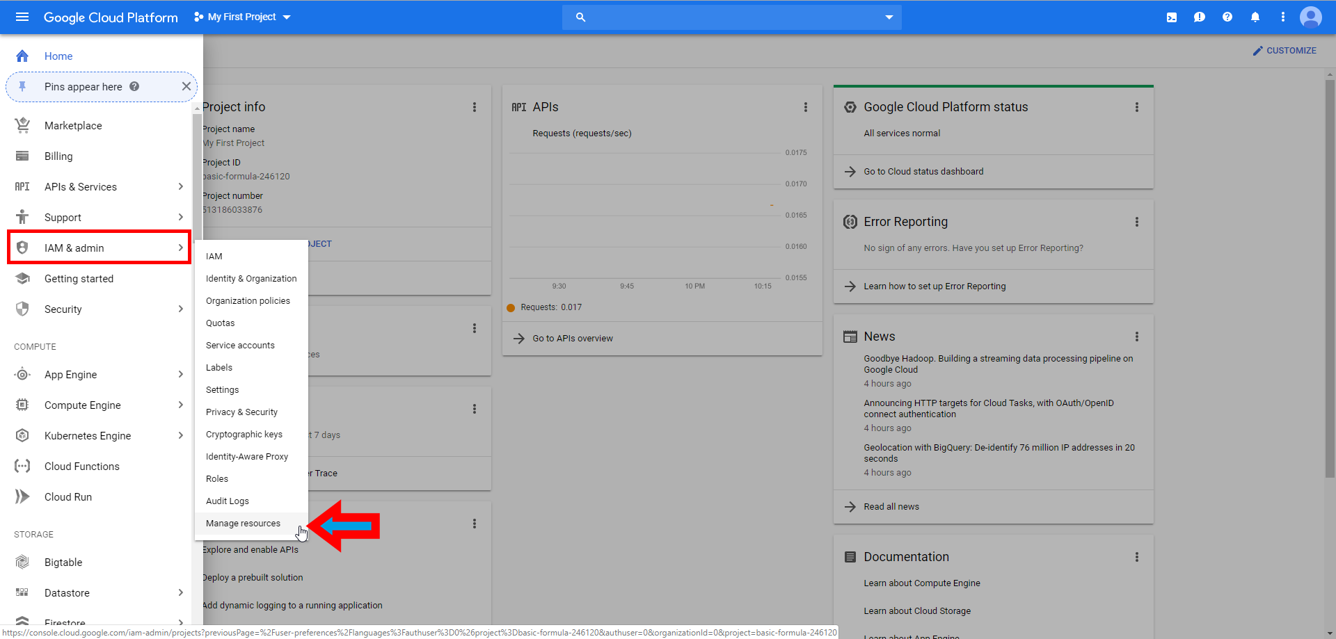

  • Select => Menu => IAM & admin => Manage resources

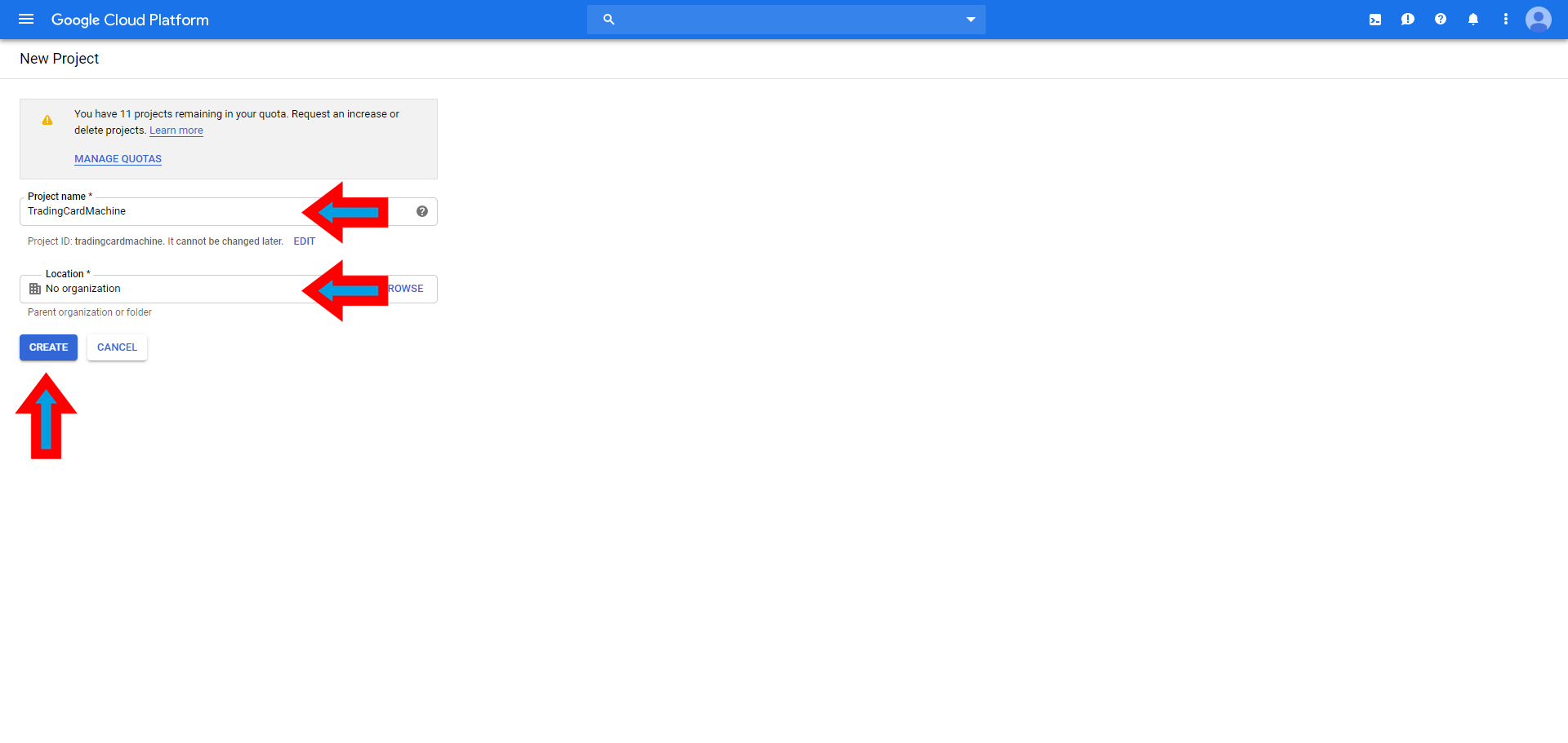

  • Create a new project
  1. Type in a "Project name"
  2. You don't need "Location"

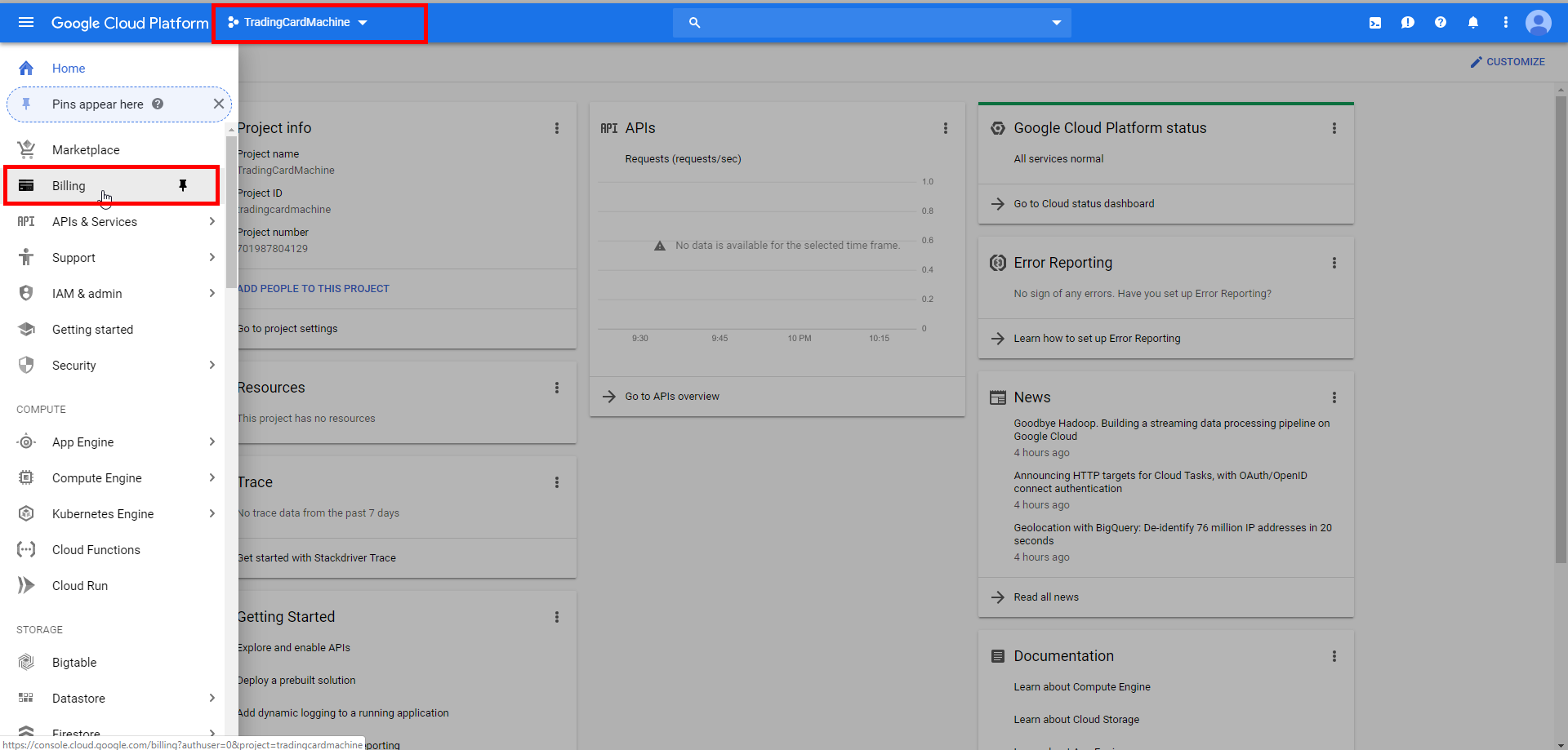

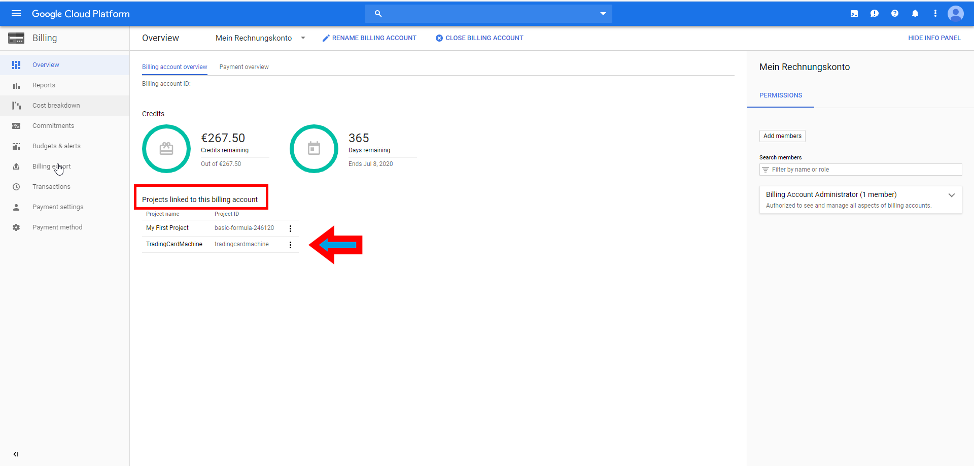

  • Back in the Home screen select your project.

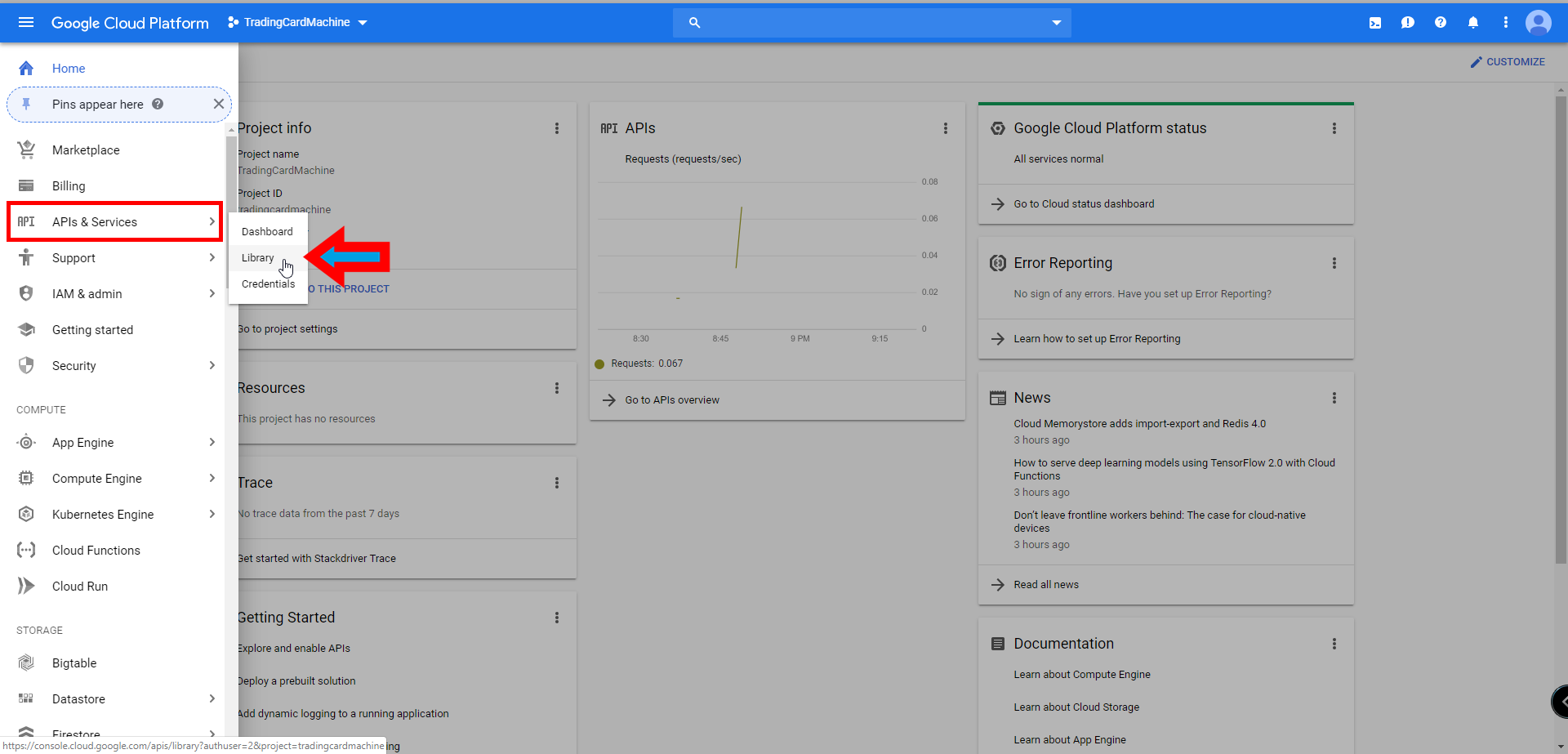

  • Select => Menu => Billing

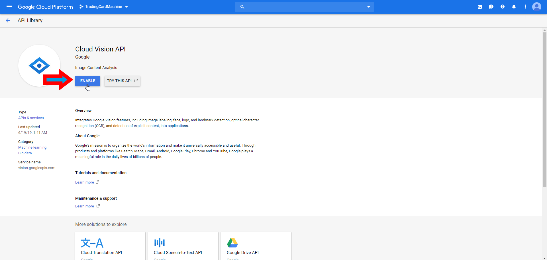

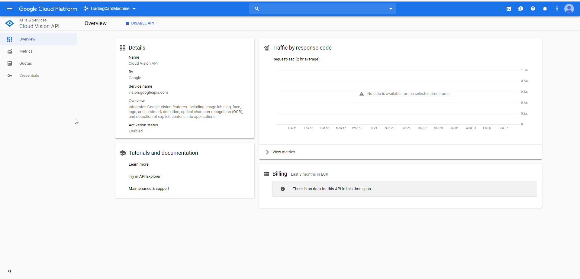

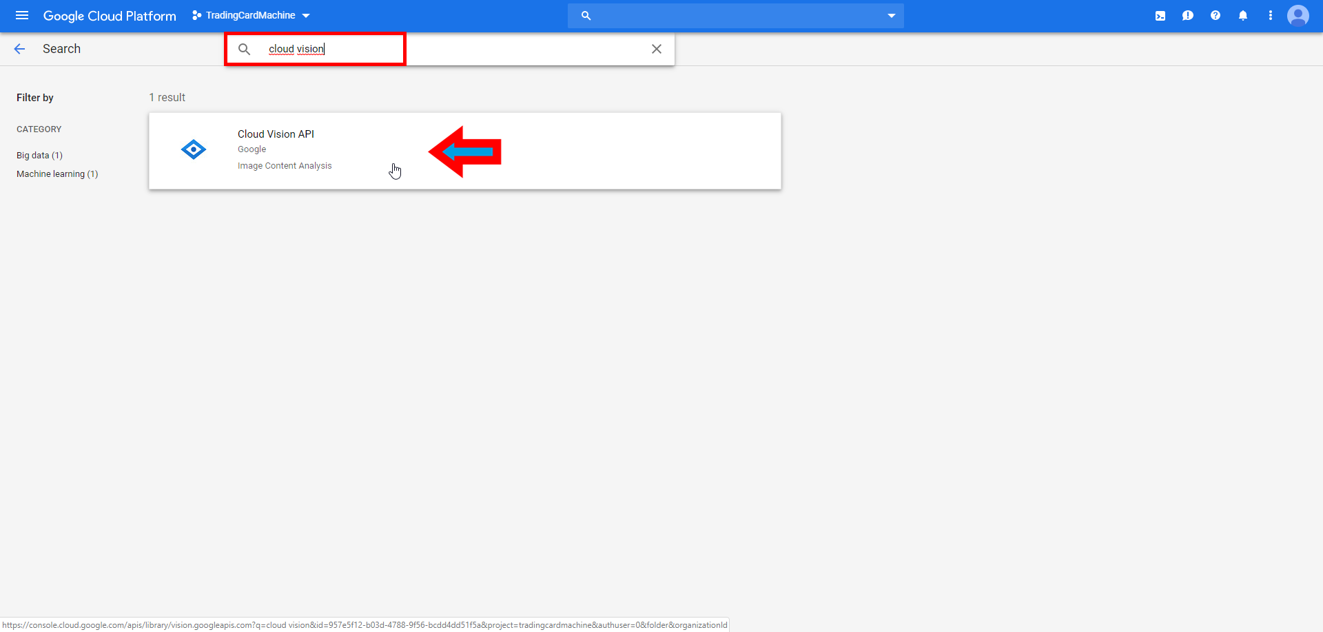

  • Select => Menu => APIs & Services => Library
  • Search for "Cloud Vision" and select the Cloud Vision API result
  • Enable the Cloud Vision API
  • Overview of the Cloud Vision API

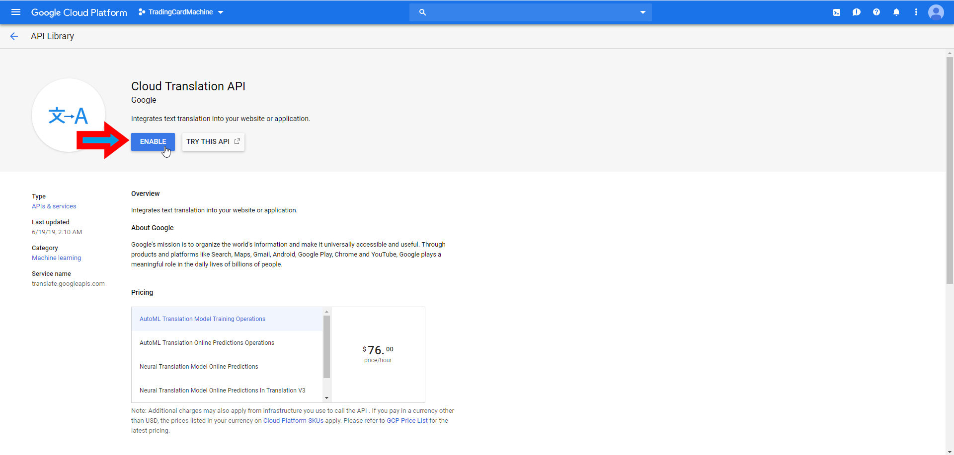

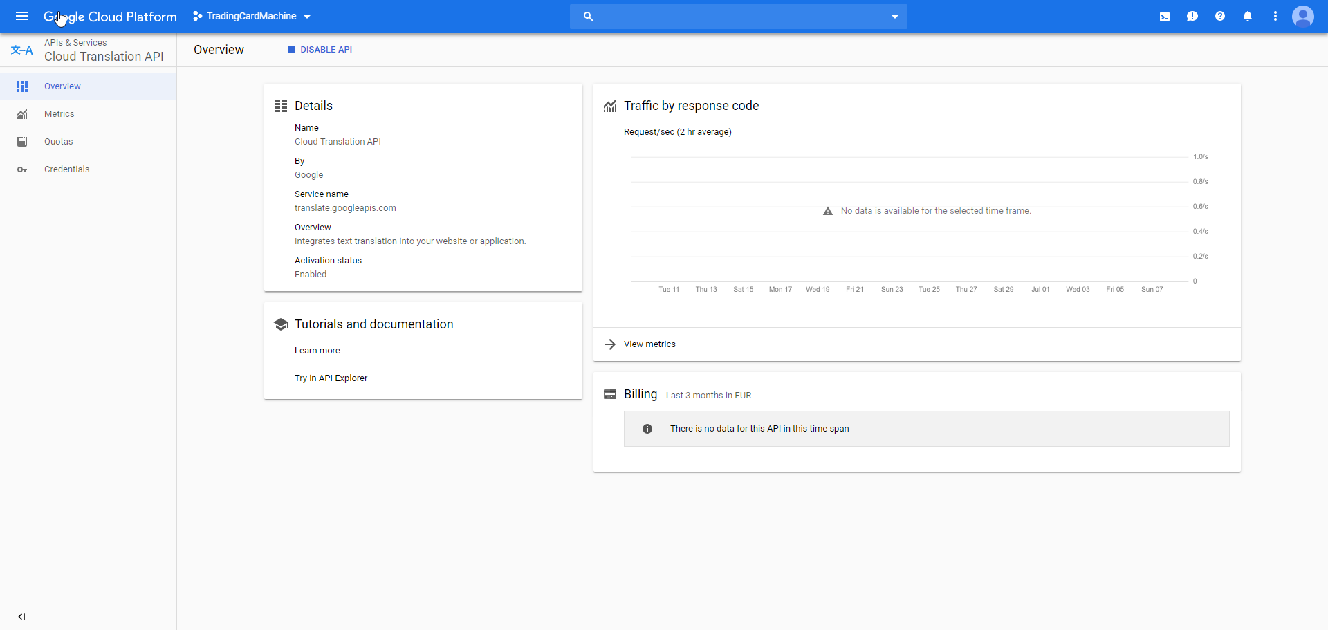

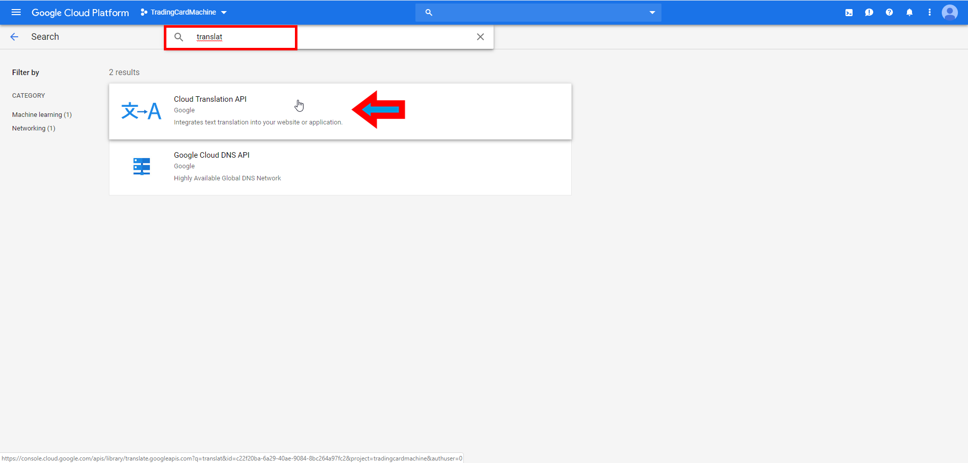

  • Search for "Translate" and select the Cloud Translation API result
  • Enable the Cloud Translation API
  • Overview of the Cloud Translation API

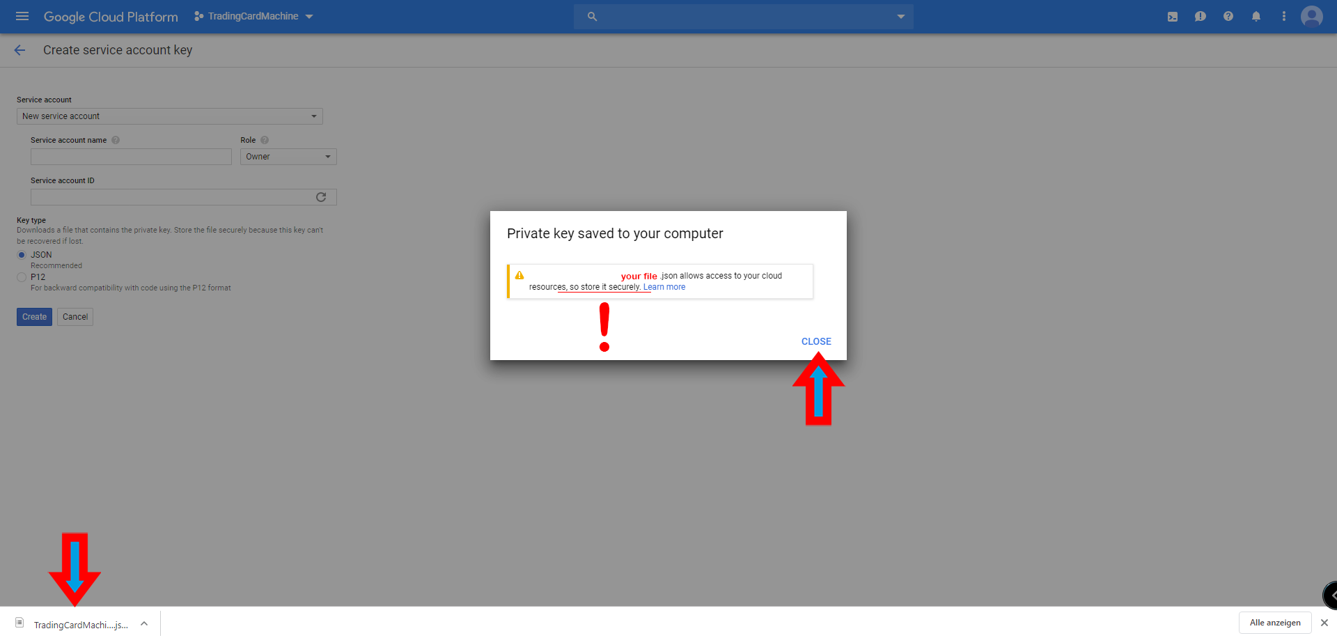

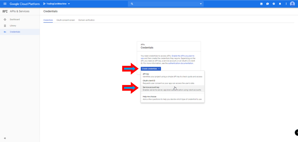

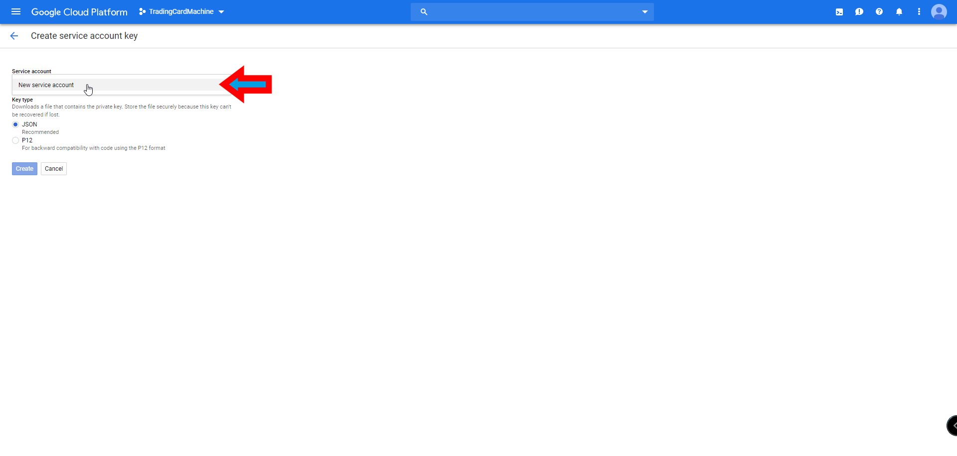

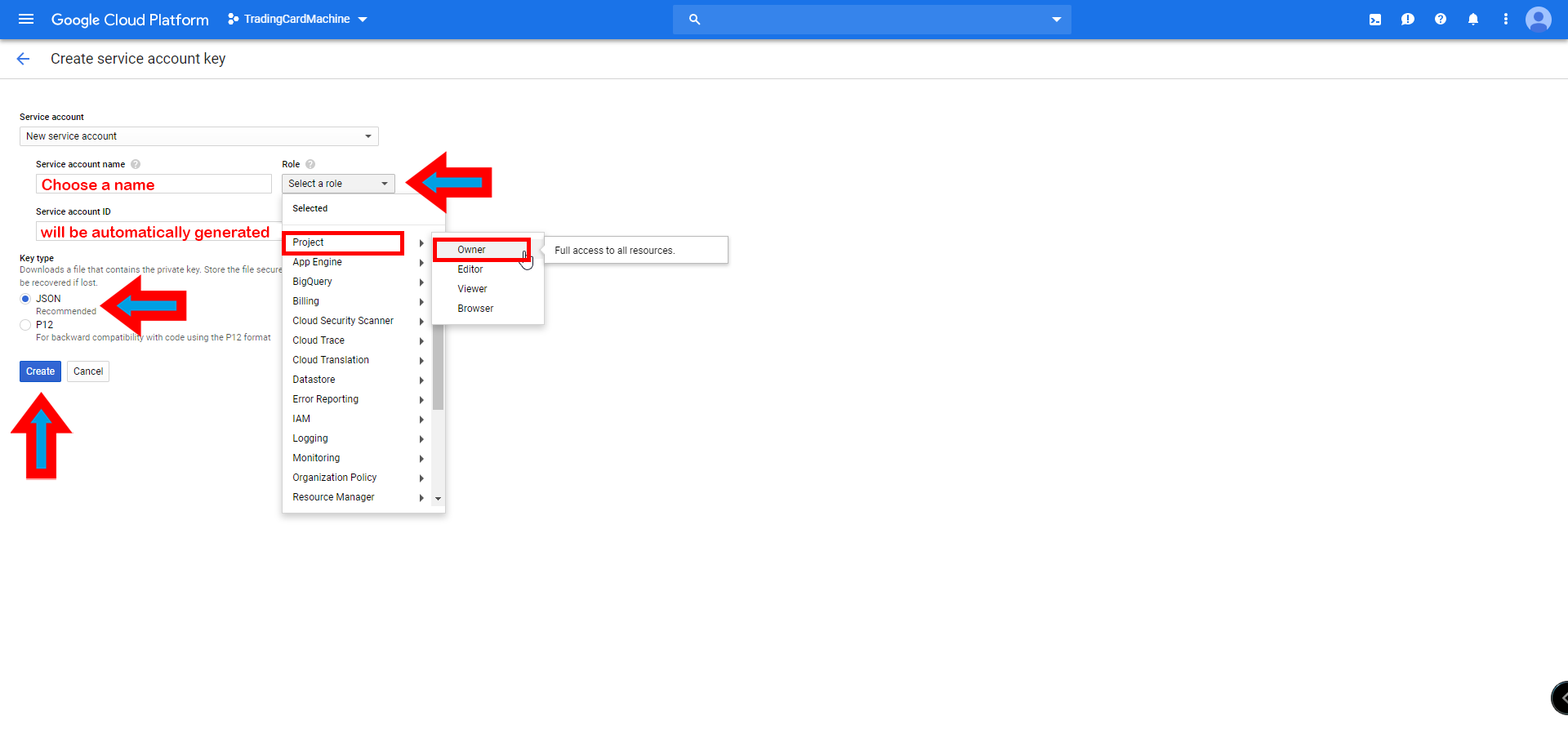

  • Select => Menu => APIs & Services => Credentials
  1. Select "Create credentials"
  2. Choose "Service account key"
  • Create a "New service account"
  1. Type in a "Service account name"
  2. "Service account ID" will be automatically generated
  3. Select => "Role" => "Project" => "Owner"
  4. Key type "JSON
  • A JSON-file is created and saved to your computer. HANDLE IT CAREFULLY.
  • The JSON file is needed in the code for the Authentication

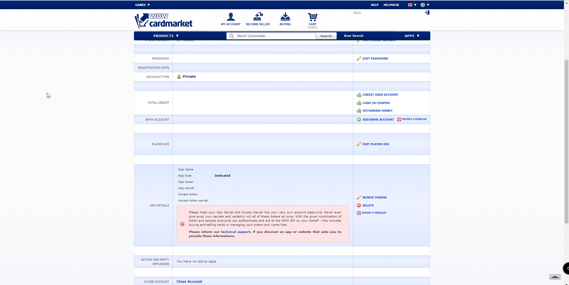

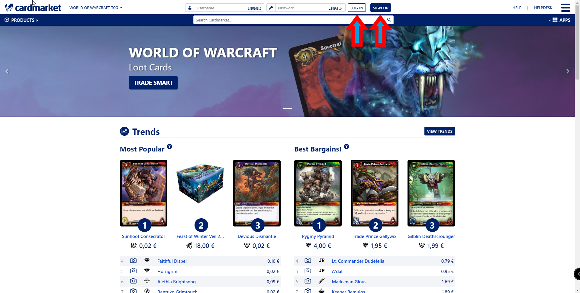

  • Login with your account or create a new one
  • Select your User and open "My Account"

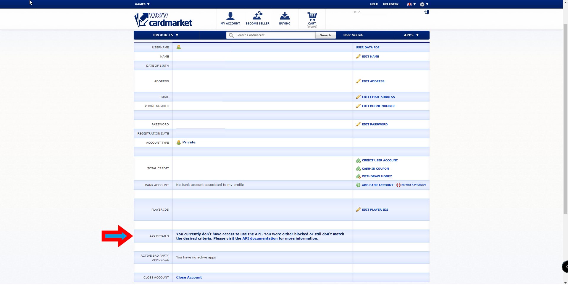

  • The guys at Cardmarket say:
  • Attention: User accounts, created in January 2018 or later, don't have default API access. You first need to perform certain actions on Cardmarket, e.g. completely finishing a purchase, or registering as a seller. If you only wish to create an account for accessing an API, you should first contact us with as much details about your planned project as possible, so we can manually grant API access.
Here you can ask them.
  • I have my account for more than 5 years, so I'm allowed to use the API.
  • Choose "Dedicated App" this means If you want to develop an application, that provides services only to your user very own account at MKM, this app type is your solution. Your app is acting with the API like you are acting with your user account using the website.
  • APP_TOKEN, APP_SECRET, ACCESS_TOKEN and ACCESS_TOKEN_SECRET is needed in the code for Authentication
