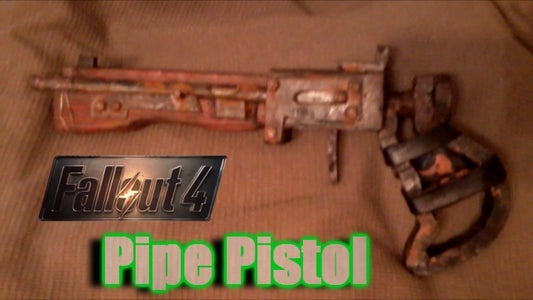

Whether you cosplay or just like something radioactive for your shelf, this prop may be for you. I've seen a lot of 3D printed ones, but some of us don't have the ability to use a 3D printer. This prop is pretty light since it is mostly EVA foam and it will only set you back around $15 if you already have the basic tools. I didn't use any scaling or measurements from the game, but I used real gun measurements as an equivalent.

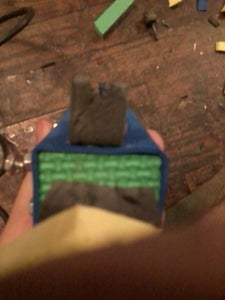

This piece is very easy to do. Cut one square around the size of the far end of the barrel/forearm section. That step is shown in the first picture. You'll need a slightly longer one, but the same width. take the larger piece of pipe, about 3 inches long and cut the foam to slide over it. the longer piece goes in the front and the shorter piece goes in the back. slide the pipe with squares onto the barrel/forearm and glue in place. Make sure the squares are even still. Take some craft foam and skin the box. Now you can cut the detail piece. This is supposed to be the bolt action of the gun or something close. I'm actually not sure how it is supposed to work in the game as it is a game and I can't take it apart and look. It is an L shape, but the horizontal piece is thicker and will have a slot cut in it, almost like the one in the barrel. Screws are added to this part, I used a pointed dremel tip to start the holes. Add a piece of foam or a bolt to the bottom of the receiver box for the trigger. In the game it is a bolt, but I wanted something a little more flexible. The rear sight goes on top of the receiver box, it is made from a piece of EVA foam that has been heated and bent into an L shape with the short side sticking up. I dremeled a notch into it, once the front sight is on you should be able to line these up. I made some small "rivets" on the rear sight base with the pointed dremel tip.

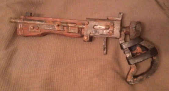

Step 11: The End
Have fun, but be careful and obey all weapon laws. Some conventions allow prop weapons, but some don't so be super careful. At this point you can go back and paint the strip around the handle black to pull off a black tape look and you can add some silver to the small slot in the barrel. In the game this can be modified in a billion ways so if you make one like I did then add something to it (optics, stock, bayonet) and drop a picture below. P.S. I know the handle it thick.
