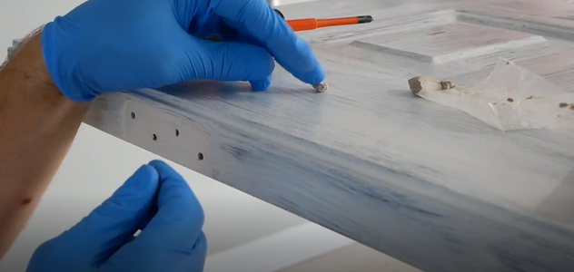

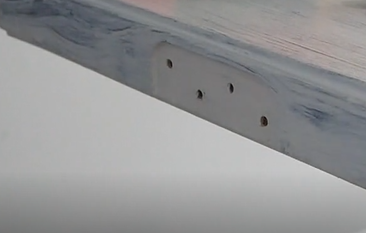

Step 1: Stripped Holes
Identify the stripped hinge screw holes

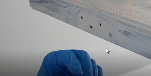

Step 2: Mix Epoxy
Mix the epoxy putty well

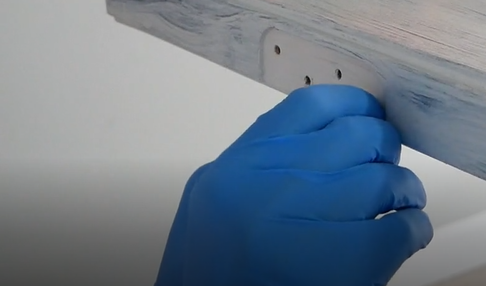

Step 3: Fill
Press the mixed epoxy putty into the stripped screw hole

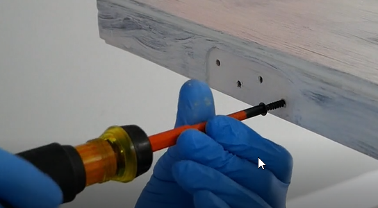

Step 4: Screw
Partially screw into the hole to push the epoxy putty in place
