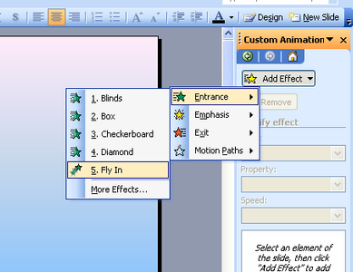

Step 8: Adding Animation!
1. Right-Click on the truck and select 'Custom Animation ...'. A tool bar will appear for the custom animation, and there you can Add an effect for animating the truck. Now, obviously as this is a truck and not a ghost, we won't be settling for the effects like Blinds or appear/dissapear. What an earthly truck can do is travel from the the right to the left of the screen. For this effect, we choose:
Entrance > Fly In
2. Choose the parameters. 'Start' is for the trigger the slide-show should look for to start this effect. I chose this as 'With Previous', so that would time my truck to drive in as soon as the slide-show starts. The direction in this Fly effect is going to be from the right side of the slide. We can adjust the speed of the truck too.
