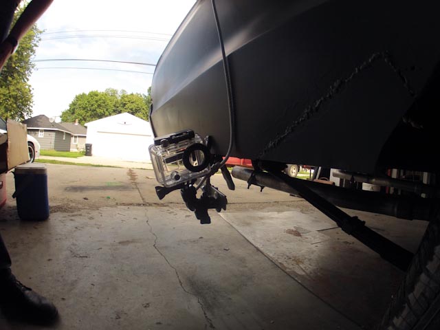

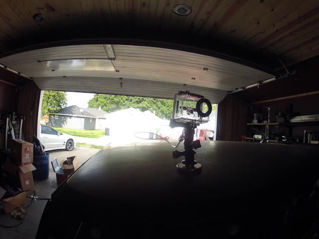

Step 6: Mounted on Vehicle
Here the cable is shown attached to various mounts I built for the project including the Fender Mount and the Magnet mount.
If you're going to be creating a DIY GoPro mount I seriously suggest using this safety cable... You know what, even if you use official mounts I would reccommend it.. (I just can't trust suction cups)
