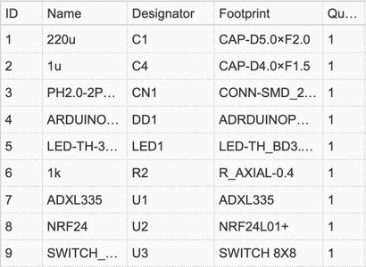

Step 4: Required Components and Soldering
The hand gesture controller needs a few components. Easy solderable components. Place and solder components according to shared reference designator.
