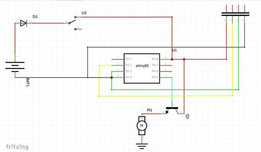

Step 3: The Schematics
The schematic can be broken down into three parts:
1. Power Supply
2. HC SR-04
3. DC Vibration Motor
The power supply consists of two CR2032s, a diode, and a SPST switch. The CR2032s in series will give us a voltage of about 6v (provided that we are using relatively "new" batteries). From the attiny's datasheet, you will find that the absolute maximum operating voltage of an attiny is 6v. Since batteries can produce higher voltages than their rated amounts, just connecting two CR2032s in series could give us voltages higher than 6v (which would damage the attiny). To lower the voltage, I added a diode in series with the batteries. This will drop the voltage down 0.7V, to ensure our attiny never receives any voltage higher than 6v. To complete the power supply, add a SPST switch to act as an on/off switch for our circuit.
Connecting the HC SR-04 is rather straightforward. Just connect VCC to our positive voltage supply, the GROUND to ground, TRIG to the attiny85's pin 2, and ECHO to the attiny85's pin 3. (The TRIG and ECHO connections are dependent on the attiny's programmed code).
The DC vibration motor requires a transistor, and an attiny pin to function. First, connect the base of an NPN transistor to the attiny's physical pin 5. Then connect the collector to our positive voltage supply and the emitter to the positive connection on the DC motor. Finally, connect the DC motor's negative side to ground. A transistor is used to operate the DC motor because the attiny's pins do not supply enough current to power our motor, so instead we use a transistor so we can supply more current to the motor.

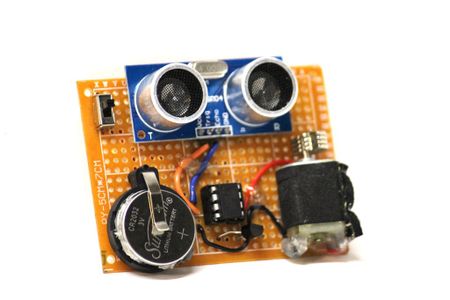

Step 5: Plan the Layout!
Before we solder, let's make sure we use our perfboard space wisely to avoid having to move components later. Here are some things to consider while planning your perfboard layout:
-Give the DC vibration motor room to spin.
-Make the SPST switch easily accessible.
-Mount the HC SR-04 straightly with nothing obstructing its view.
-Make sure the batteries can be easily replaced.
When you have considered these, we can finally solder our final circuit!
Step 6: Solder!
Before soldering any components to the perfboard, be sure to hot glue your DC motor to the board. This will protect any wires from being disconnected later on.
To begin soldering, I connected all the major components to the board first (such as the motor, attiny socket, hc sr-04). Then I made the necessary connections after. However, any way you solder your circuit will work, of course.
This circuit shouldn't need too much troubleshooting since there aren't many components, but if you run into problems be sure you connected two batteries and your diode since this circuit needs more than 3v to function (due to the voltage drop of the DC motor). Refer back to the schematic, and your breadboarded circuit for help troubleshooting!

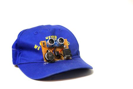

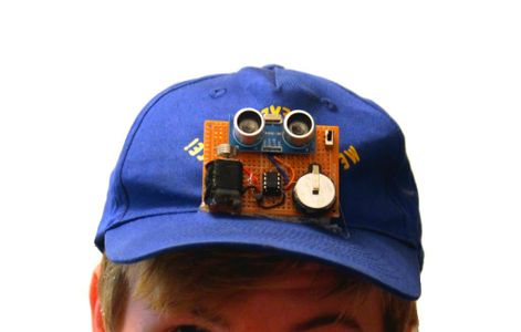

Step 7: Mount It!
Since this device is so small, it can be mounted to many surfaces (such as clothing, hats, belt buckles, etc...). I chose to mount mine to a hat to prevent against accidents involving low ceilings in homes. Because if the varieties of mounting surfaces, I will give you a list of ways to mount your Helping Eyes:
-Use Hot Glue or Epoxy
-Make the circuit using a arduino lilypad and sow it into clothing.
-Attach using velcro
-Screw it into your mounting surface
There are many ways to mount your Helping Eyes, please share your mounting alternatives below in the comments!
