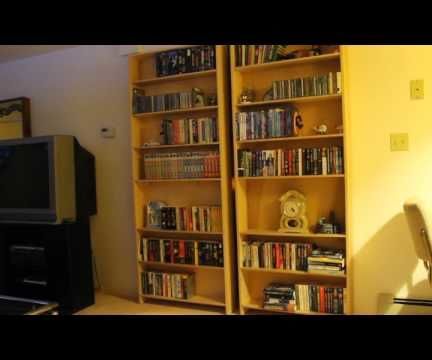

The design and construction was based on my own design. It wanted the doors to be fully functioning bookcases with a unique opening mechanism. They hinge inward and then slide outward. This way they don't take up room either inside or outside. I used maple hard wood for the strength and since other furniture in the room is maple colored.

The 2nd door was attached to its slides. Some shelves were added. I allowed about 1/4" clearance between the back of the book case and the wall and on the top and bottom. This helps reduce the amount of light that could leak out and ruin the illusion. I may staple in black felt to further insulate them.
Step 10: Testing the Movement
The doors hinge inward and slide outward very easily on the bearings. I estimate each door is less than 100 lbs. Even when loaded with books, cds, dvds, etc. they should be less then the ratings.

Two small handles were added to allow closing from the inside. I could have spent more time choosing better wood but I didn't consider how the inside would look until completed.
So far, there is no sagging or rubbing on the carpet. The doors are very easy to open and close.
