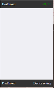

Step 2: Mobile App.
Download the android mobile app attached here. and install in your mobile.

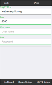

Go to MQTT Setting Tab and add your broker name and Port.
It require a web socket so enter the web socket port of your broker. For test.mosquitto.org web socket enabled port is 8080.
Step 3: Mobile App Configuration
Open App in your mobile and
1. Go to device setting.
2. Select new device.(when you do configuration 1st time only new device option is available).
3. Device name: you can give any name for your device in my case its lamp.
4. Device type: switch(leave as it is).
5. Topic: give topic for MQTT.
6. On command: This payload will be send when switch turn on.
7. Off command: This pay load will be send when you toggle switch to off.
8. Pess DONE button.
9. Go to Dashboard. you can see your device is generated.
10. follow all step for FAN configuration.

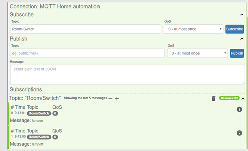

Step 4: Test Configuation
For testing configuration many tools are available but i prefer MQTTlens. It a chrome addon.
Go to https://chrome.google.com/webstore/detail/mqttlens/hemojaaeigabkbcookmlgmdigohjobjm?hl=en
- launch MQTTlens.
Add connection
connection name: any
Host name:test.mosquitto.org
port:1883
save detail
Subscribe with the topic you inserted in device setting.
toggle switch in your mobile you can see response in MQTTlens.
