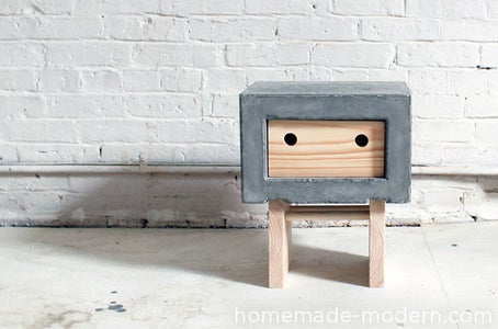

Did you know you could use LEGO Bricks to form concrete? I had so much fun making this funny little nightstand that looks like a robot. I was skeptical about how well this idea would work, but everything went smoothly and Lego-formed concrete is my new obsession.

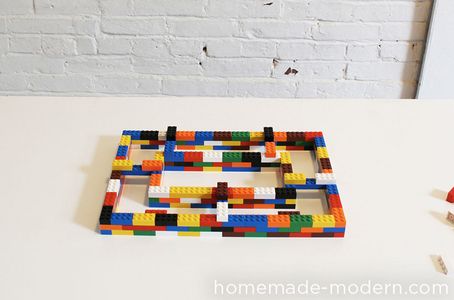

Step 2: Layout the Mold
Layout the design and build the mold 3 bricks high. Place temporary spacers to get the inside and the outside rings in the right position.

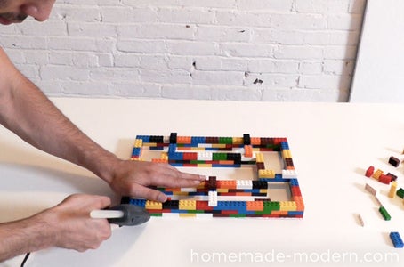

Step 3: Glue Down the Legos
Use the hot glue gun to glue the Legos to the melamine board.

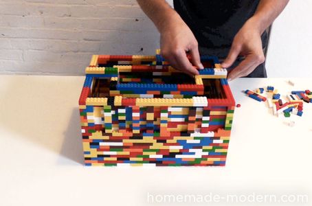

Step 4: Finish Building the Mold
Build the mold up brick-by-brick. When you get to the top, place some support braces to keep the walls from bending out under the weight of the concrete.

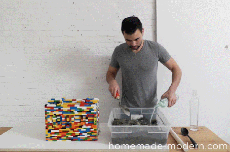

Step 5: Mix + Pour the Concrete
Mix the concrete and spoon it into the form. After you have put in about 3 inches of concrete, use a stick to push the concrete into the corners and vibrate the air bubbles out of the concrete. Repeat this process until the mold is full.
Step 6: Level + Smooth
I used a trowel made from Lego bricks to level and smooth the concrete. Don't worry about this too much because the melamine side of the mold will be the front and will come out nice and smooth.

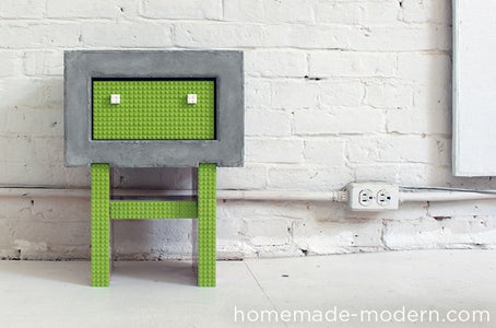

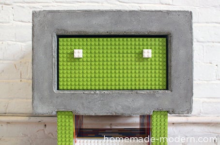

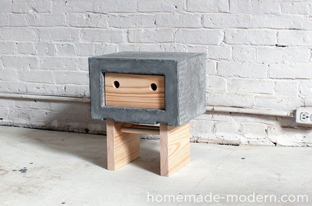

Step 9: Add a Drawer + Legs
You can make a wood base and drawer for this nightstand or use LEGO bricks. The concrete part is quite heavy, so you might want to glue the LEGO together if you do use them.

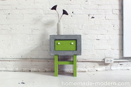

Step 11: Finished!
Good luck making your own concrete nightstand and please email or tweet photos to @benuyeda or ben@homemade-modern.com. For more DIY ideas and projects, visit us as HomeMade Modern.
