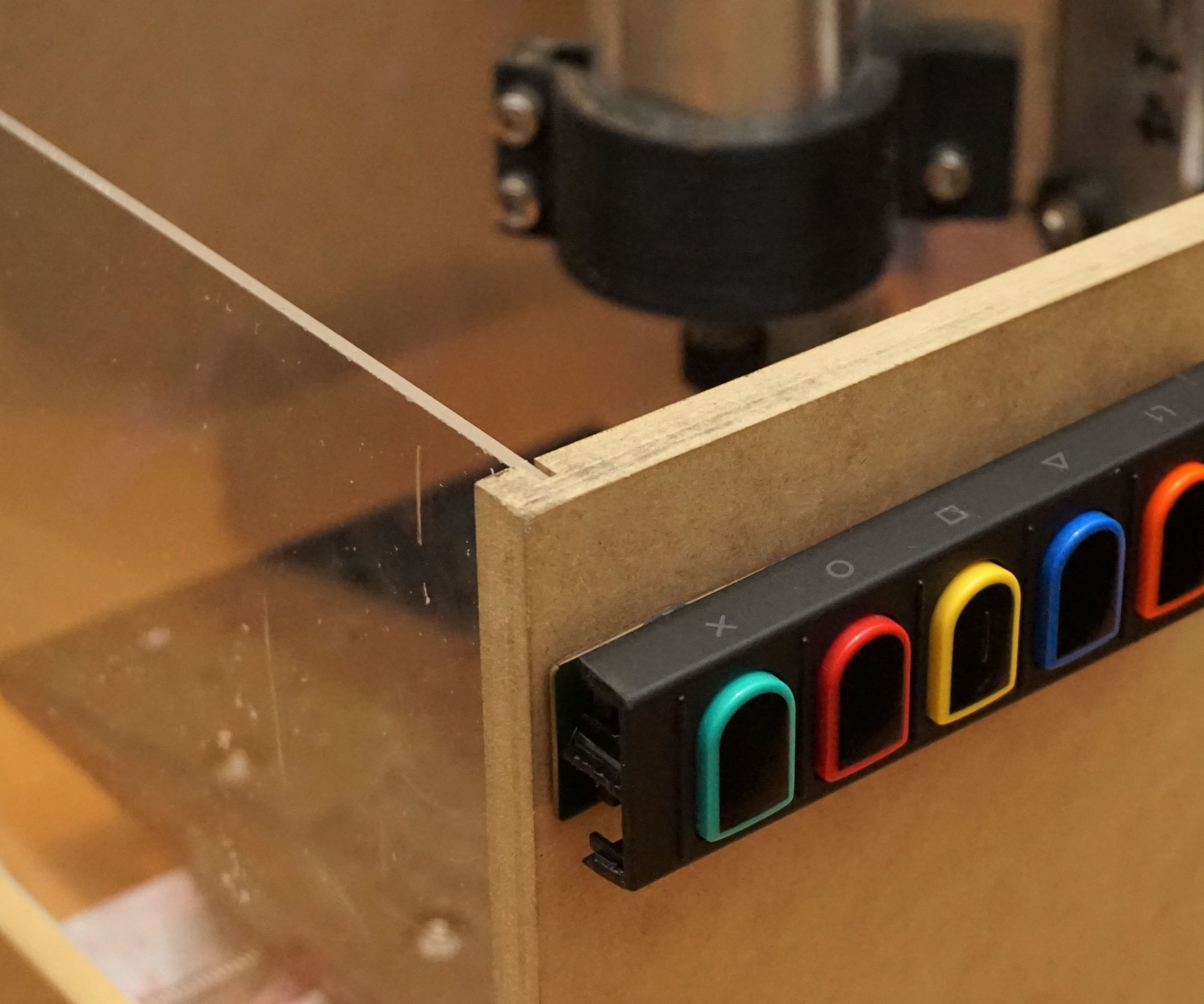

Step 7: Assembling the Frame
Start by putting the x-axis motor through the hole in the right-side frame piece, then screw the brackets in place using the longer M8 screws and nuts. Once the x-axis is also secured to left-side frame piece, and the y-axis secured to the front frame piece, mount all four of the aluminum brackets to the left and right-side frame pieces using the M8 screws and nuts.
Slide the y-axis assembly into the x-axis assembly and slide the back piece in to meet it. Use the remaining screws to finish assembling the frame and don't forget to also mount the 3D printed Arduino bracket onto the back of the frame.
Note that it's fairly critical that the bottom part of the frame is flush to the surface of your table. This makes sure that dust doesn't escape under the frame and also that the machine cuts accurately.
