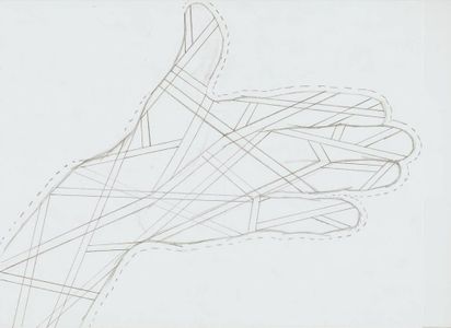

Step 1: Map Out Your Design
Here I drew one side of a hand I am currently working on. I clearly mark-out, with heavy line-weights the bands that will form to "positive" aluminum bits of the sculpture. The "negative" spaces in-between will be what we cut out. You will use a chisel because as you can see from the drawing, the "negative" spaces in-between are completely surrounded by the "positive" spaces and will not be able to be cut with shears.
NOTE: The first few times you do this you might want to take a sharpie and go over the "positive" parts you want to keep. This will help you keep things strait as to what you are cutting out and what you are keeping. You will see this method in some of the images on the next few steps.
The dotted lines surrounding the hand is where I will cut out the whole image using shears (see below).

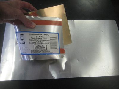

Step 2: Commandeer Aluminum Flashing
Aluminum Flashing can be found at any hardware store; it is used for a number of construction needs, but mainly in roofing where it is bent and tarred as a waterproof barrier between masonry and asphalt roof tiles.
You can buy an entire roll for about $5 to $10, depending on the width of the roll. You can also find some that have a gold-metalic finish on the inside!
If you are on a budget, you can probably find some in your basement or attic as well.
