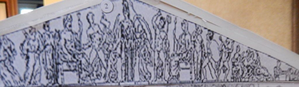

Step 5: The Freizes and Pediments
Now, all you have to do is print out the provided pics, and glue them onto the listed places. Start by printing and cutting out the pics above. Next glue the long rectangular strips around the edge of the roof on the small edge pieces, so that they wrap around. You may have to reprint some of these, but that is ok. Now take the triangular pics, and glue them on the triangular part at either end of the roof.
