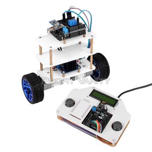

Introduction: How to Build SainSmart InstaBots Upright Rover Kit V2.0 Updated
With the balancing robot we aimed to create something that beginners and experts could both enjoy. We provide all the parts and easy-to-follow instructions, you provide the final result. The beauty of our self balancing robot is that it is totally customizable; it starts from our design but can become something totally your own. Add sensors, cameras or any other parts and pieces you can think of. Designed by our top product engineers and approved by beginner enthusiasts, the self balancing robot leaves no room for excuses.

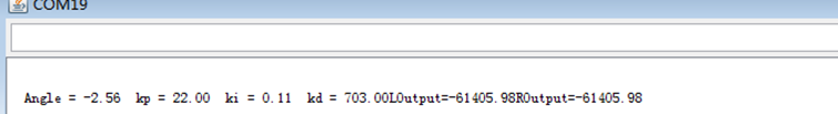

5、 If your car fail to keep balance please check the values of PID, you can check them through serial port on your PC
The typically values are shown as above

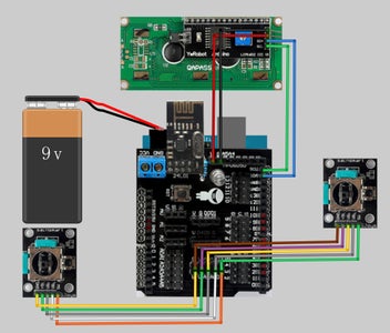

Step 2: Wiring for Controller:
1、 Use the Dupont Line to connecting LCD and joysticks with the shield board according to the way shown in the picture above,then inserting the shield into UNO.
2、 Please refer to the Assembling_Video_for_V2 for Assembly instructions

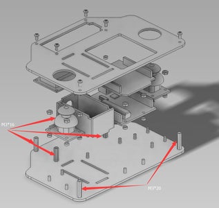

Step 3: Tips:
there are tow kinds of plastic screws
