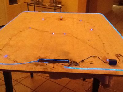

Step 1: Cut Your Plywood to Your Desired Table Size.
We chose to keep the 4ft of width for a larger work area, and trimmed off 24" for the length.
Step 2: Cut Holes for Cords Etc...
We then used our Fostner 1 3/8 bits to cut holes for plugs, and used a jig saw to cut out a trash shoot. We then used a finishing sander with 320 and then 400 grit sandpaper to give us a radius on the edge of the table and rounded smooth edges.
Step 3: Stenciling and Painting.
We then began the process of stenciling images on the table top, we chose the Makey Bot and various other symbols.
Step 4: Next Up Paint...
We then used spray paint for the stenciled images, red, blue, yellow and black.
Step 5: The Extras
We drilled 1 3/8 holes on the top of the table for our white plexyglass pucks which we lit up from underneath with blue LED's, we the used the poly urethane and applied 4 coats to the surface sanding with 400 grit paper in between coats.

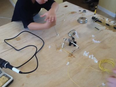

Step 6: Wiring the LED's and Adding EL Wire.
We then wired up the LED's under the plexyglass pucks using silicon to help hold them in place and soldering them together. We used a coin style battery holder and a push button switch located on the table top to activate the LED's. We then used approx. 20 feet of EL Wire and hot glued it to underside of the table and wired it to the inverter and a 12 volt AC/DC plug.
Step 7: The Finished Project
After adding the adjustable legs purchased from IKEA and mounting it your done...we hope you enjoy the table.
