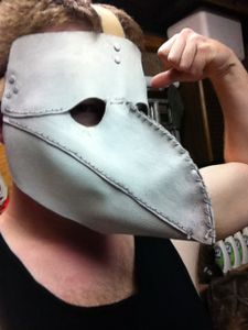

Step 1: Forming the Template
Alright, these next few steps are THE MOST IMPORTANT.
Take your mask (I used a Guy Fawkes mask from "V for Vendetta") and use your paper to make a template, get at least one side looking just how you want it.
Take your time, paper is much cheaper that leather, and you will thank yourself later for this step.
In the photo I got the whole left side done just the way I wanted it to look.
*If you aren't comfortable with leather work (I assume you are, or else you wouldn't be here) this is a good time to stop, Papier-mâché the template, and use it like that.*

This is where I decided to put the straps on, Find where the mask would comfortably sit on your face, drill some holes, and rivet the straps to the mask. Follow the directions on the Rapid Rivets box for best results. Make sure to do this quick, we still want the leather damp (NOT SOAKING WET) for the next step.
Step 15: Patience Is a Virtue Little Babies...
This may take a while depending on the dye you chose.
I chose white...
Dye the mask according to the directions on the bottle, you may have to put several coats on.
Don't be discouraged, the lighter the dye the more coats you will need, try getting some alcohol based dye.
Step 16: Huzzah!
Huzzah it's the right color now!
And being creative DIY people you've already put a belt buckle on to one of the strap, some holes in the other, and a loop on the the top one to keep it on your face!
I'm so proud of you guys...
