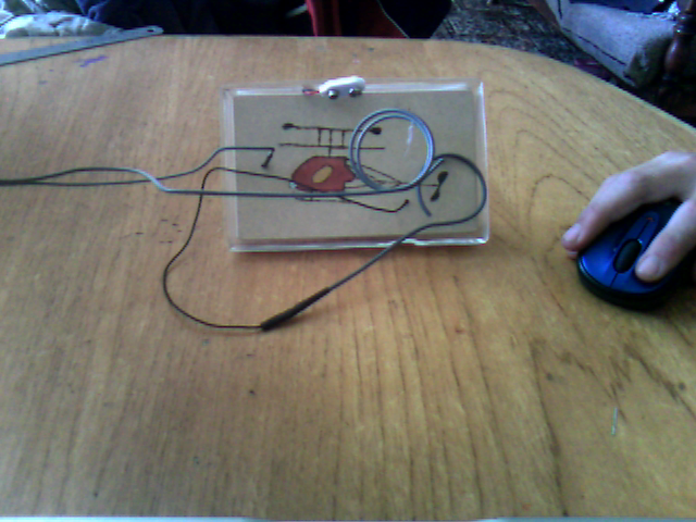

In this instructable I will show you how to waterproof a circuit board. I will be waterproofing a cheap RC receiver from HobbyKing, but the same method can be applied to many different boards. I have used this technique for a few years now, and never had issues with it.

Mix a generous amount of epoxy that you are using as per directions. You want enough to give a thick coating over the entire board. You will need to work fast as the epoxy that I used set in about 5mins. Avoid any place that you do not want to get sealed up. For any parts that get warm, make sure that the layer of epoxy is as thin as possible. Also epoxy to the edges of any heat syncs, but not over them.
Hang the board up to dry afterwards. I used the antenna cable to hand mine, but you could but in a plug to hold it from.
After dry, inspect the board for any places you might have missed. You might need to do another thin coar to cover up any places.
