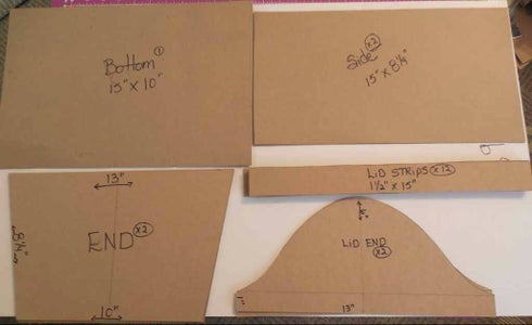

The pattern was created on 11"x 17" paper. You can print the design out on this size of paper or just print and piece together. Before cutting out please check sizes,then proceed to cutout the patterns. There are 5 pieces,transfer the pattern to thin card board or card stock.
  1. (12)pieces of the lid strip(one will be cut down at the end, to finish)
  2. (2) of each of the ends and side
  3. (1) for the bottom.
You will be adding 1/4 INCH EDGE around all the pieces, when you go to cut them out of the Shaper sheet.
Now with Shaper sheet is rolled out, foil side up ,place down your patterns( best to do the lid strips first,then move on)When you have your pattern down on foil side, take the dull pencil, remembering to leave that 1/4" space, trace the shape this will scribe it and make it easy to cut. Do this, to all your pieces.
