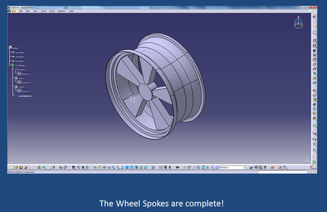

Step 36: Creating Spoke Pattern
Click Insert > Transformation > Circular Pattern > Change instances to 5 > change spacing to 72
Step 37: Creating Spoke Pattern
Click on Reference Elements > click on the central lug > Press OK
Step 38: Creating Spoke Pattern
The Wheel Spokes are complete!
