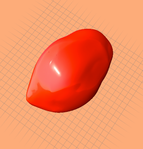

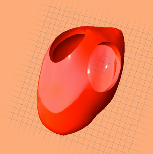

Step 1: 3D Modeling a Abstraction of a Heart
First I downloaded a 3d human heart model from the internet for free. Then I modified it using Meshmixer software from Autodesk.
I created the shape I wanted and with the size to fit all the electronics inside.

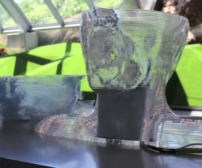

Step 2: Laser Cutting the Shape
I sent the model to 123d Make and selected Stacked Slices as construction technique and sent to cut in the laser cut using 2 plates of MDF 3mm.
I glued it in 2 parts up and down to be able to insert electronics inside after all. I used wood white glue.

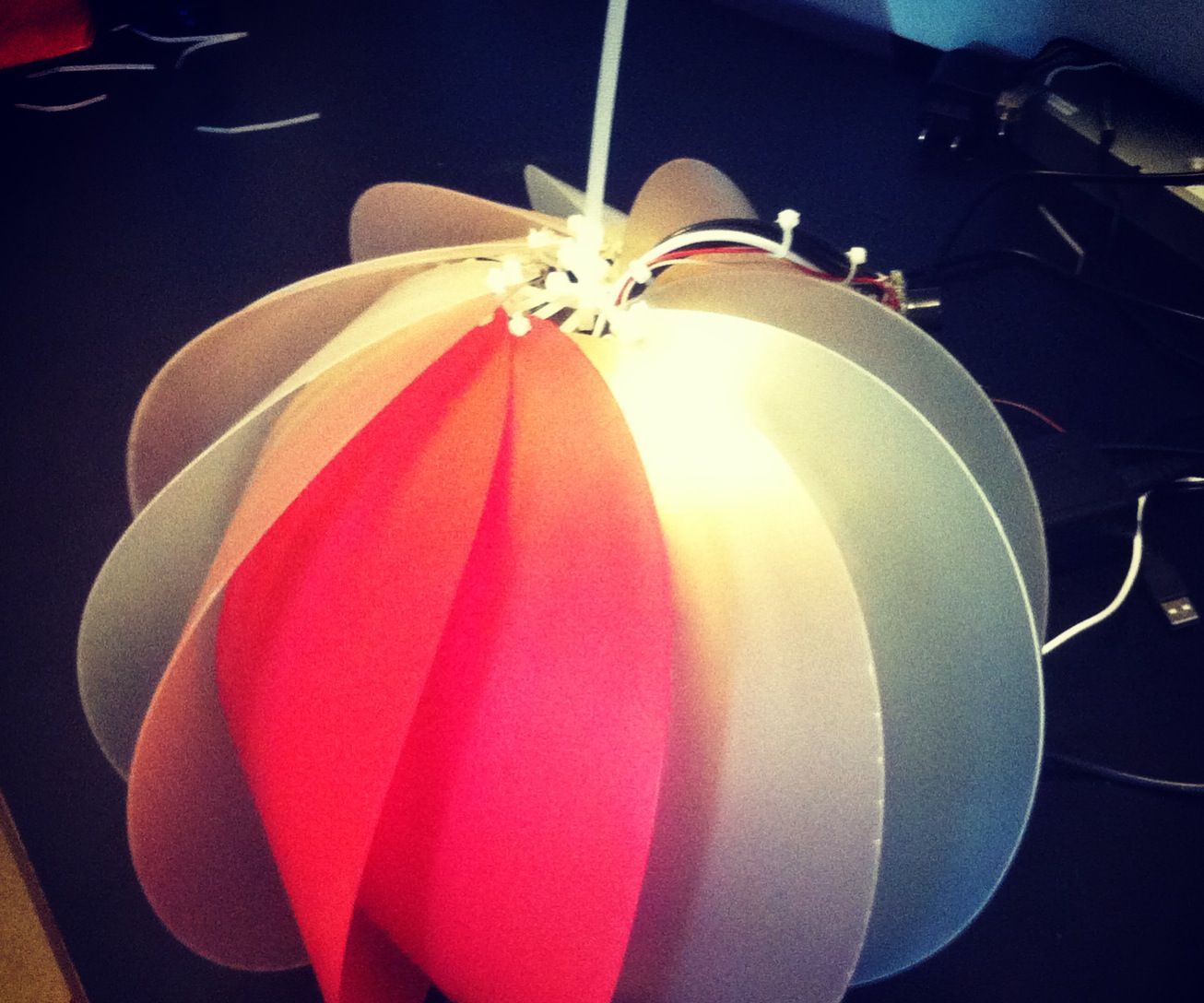

Step 3: Electronics : Pulse Sensor, Arduino, El Escudo Dos Shield and EL WIRE
The piece is using one pulse sensor to pulse 30 meters of EL WIRE lights. Each 15 meters is connected to a pin of Arduino and they pulse as the heart L with 2 pulses.
First we were soldering the EL Escudo dos shield in the Arduino using the head pins in the picture number 3 above. Each pin of the EL Escudo Dos shield could power maximum of 15 meters of EL WIRE. When you buy El wire make sure that they come with the small head pin connector, which is the same as the El Escudo Dos Shield. We programmed the lights first and then we added the pulse sensor.
Second we connected the pulse sensor on pin number 13 of Arduino.
When all the interactivity were done, I encircled the El wire around the wood shape gluing it with hot glue.
Observation: We tried to connect 2 mini servo motors but it didnt work. There was too many vibrations in the motors when they worked together with pulse sensor.
