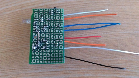

Step 1: Building the Device
HARDWARE:
The schematic has been reduce to the minimum and can be easily wired on a perfboard.
Just follow the schematic.
Arduino ENC28J60 Shield Components
D3 (in) - GM tube (INT0)
D4 (out) - LED GM tube
D5 (in) - Push button (with internal pull-up)
D10 (out) CS -
D11 (out) MOSI -
D12 (in) MISO -
D13 (out) SCK -
D14/A0 (in) - HV divider (/455)
RST (out) RESET -
VIN - 5-9V
GND GND GND
There has been an additional 5V regulator (7805) added because the onboard Arduino Nano 5V regulator is not well dimensioned to support the voltage conversion from Vin to 5V required to power both the Ethernet shield and the Nano.
The device total consumption is 160mA (1W) and about 40mA is drained by the poor performance high voltage booster.
NOTE: The 400V High Voltage depends on the internal 5V and must be adjusted with the attached DC pack running.

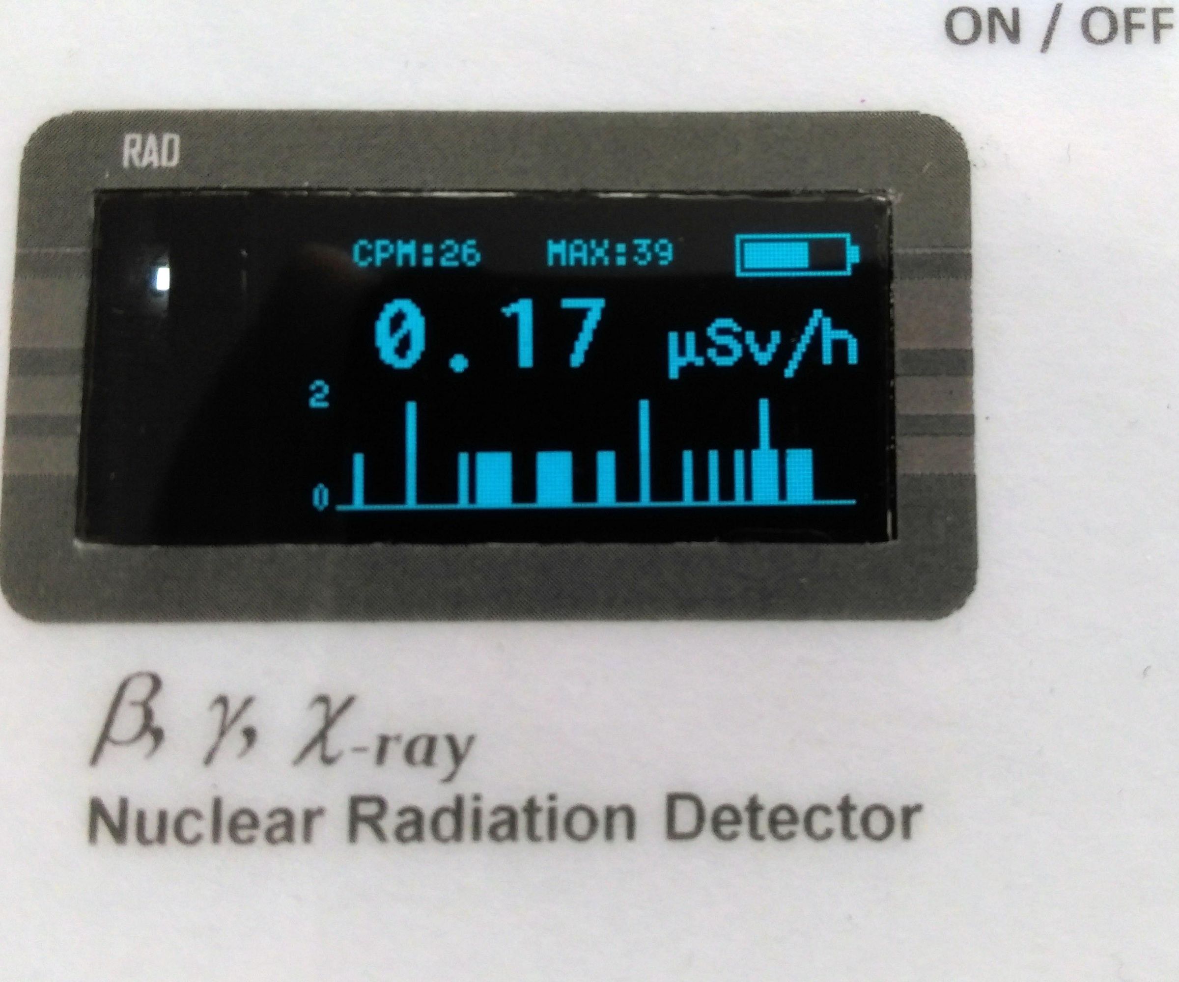

You shall calibrate the CPM of the tube (FAC) with comparison with an other GM counters or a calibrated radiation source if any. To do so, connect the USB port to a terminal and issue the new conversion factor using the FAC command (e.g. FAC=150.8).
The internal voltmeter shall also been calibrated. Place a high impedance multimeter on the outputs of the high voltage module and read the internal voltage (press the SEND button and read returned values in the terminal). Modify the HV conversion ratio using the HVL command such as HVL=155. Increase or decrease the HVL values until both values read on the multimeter and inside the terminal match.

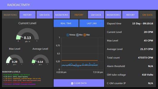

Step 3: The Web Interface in Node-RED
You can add this device to your existing home automation by creating a MQTT device input.
For those having a Node-RED environment available, you may import the JSON file below into your Node-RED Dashboard (requires MQTT broker and SQlite for a permanent database).
NOTE: This JSON flow is still under development. If you intend to build this device, check back the project for latest updates.
The messages are send every minutes where the topic is made of the CID/ and the payload. (e.g. CGM/CMP gives the current radiation measure in count per minute)
IOT:
"MQTT messages":
CMP Cout per minutes. Radiations detected within the last minute
MAX Maximum CPM since startup/reset
AVG Average CPM since startup/reset
TOT Total counts since startup/reset
ELP Time elapsed since startup/reset
FAC CPM to µSv/h conversion factor
"MQTT command":
RST Reset all device counters (e.g. CGM/RST to clear measures)
==> You have to change the path of the DB nodes in the Node-RED dashboard to match your system.
The "CLEAR DATA" button erases all data store into the database and reset the CGM MQTT device counters (Average CPM, Max CPM and elapsed time).
Press the "SEND" button on the device to output values.
The database is updated every minutes with the new values.
The plot displays either the last hour or the last 24 hours. The two curves will be identical after power-up during the first hour.

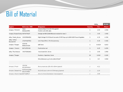

Step 4: Bill of Materials (BOM)
You will find here above the list of components I used and theirs respective prices. This list is given for information only and it is not required to cope with the list above, therefore alternative components can be used as long as they match the characteristics of the listed components.
