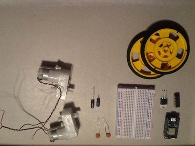

To build this Wi-Fi Leap Motion robot you will need:
- 1x Particle Photon (a Core may work too, but I haven't tested this)
- 1x L293D dual H-bridge motor controller
- 1x LM7805 voltage regulator
- 2x 100uF capacitors
- 2x 0.1uF capacitors
- 1x power switch
- 1x half-size breadboard
- 1x 9V battery
- 1x motor power battery (I used 6 AA batteries which gave me 9V total)
- 2x motors with wheels (I got mine from an old line-following robot kit)
- 1x robot body (I used a 4.75" x 4.75" piece of plexiglass)
- 2x small bolts (these will keep the front of the robot from touching the ground, and can be any size)
- 4x nuts (these will attach the bolts to the robot body)
- Some wire
- Tape

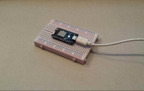

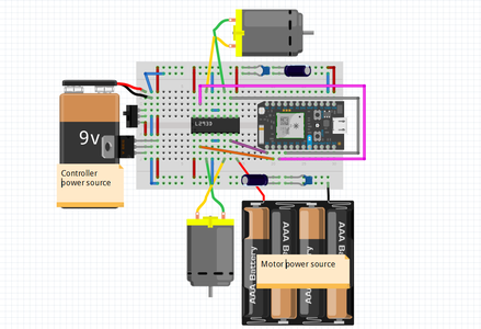

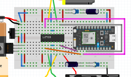

Now that you're sufficiently excited about the Photon's capabilities, let's start this project by building the robot's electronics. I've attached Fritzing drawings of the circuit, and attached the Fritzing file to this step. The circuit is pretty straightforward.
Once you've made the circuit, check your wiring and make sure everything is in place. If everything passes inspection, turn on the circuit. The Photon's RGB LED should pulse white, then blink green, then slowly pulse cyan, indicating that it's operational and ready to be controlled.

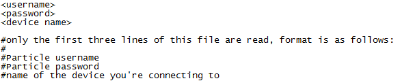

Step 9: Setup the Keyboard Controller Program
Before using the Leap Motion, let's first test the robot with simple keyboard controls. Download the attached .zip file, and unzip its contents somewhere on your computer (I prefer the Desktop). You'll also need Python 2.7 installed, so make sure you've done that before continuing.
Now, the Python script requires your Particle username, password, and device name to function, so make sure you have those on hand. Also keep in mind that they will be saved in an unencrypted form (a text file, to be exact) and thus should be kept in a secure location on your computer.
To make adding your Particle information easy, I set up a config file system for this program. Just open the folder you downloaded and open config/pyPhoton.txt. Replace username with your Particle account's username, password with your Particle account's password, and device name with your Particle device's name.
Finally, open a command line window and type cd(path)/pyPhoton, where (path) is the location of your pyPhoton folder (for example, the Desktop's path on Windows is "C:/Users/user/Desktop"). Turn on your robot, then type python pyPhoton.py. If all goes well, a black window will appear; once this window has appeared, your robot should be functional!

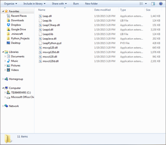

If your robot functions with keyboard control, then you're ready to go touchless with a Leap Motion! To do this you will need a copy of the Leap SDK, which can be obtained (after signing up as a developer) from https://developer.leapmotion.com/. You'll also need the Leap Motion controller script, which is attached to this step in a .zip file. Download and unzip its contents somewhere on your computer (again, I suggest the Desktop).
The Leap Motion SDK is simply a collection of files that allow programs to interface with the Leap Motion. Which files you need depends on your operating system, so make sure you know what OS you're using (and whether it's 32-bit or 64-bit). Once you know this information, check the list below to see what files you need from the Leap SDK.

Copy the files your operating system requires to the same folder as the Python controller script (the folder should be called leapPhoton).
