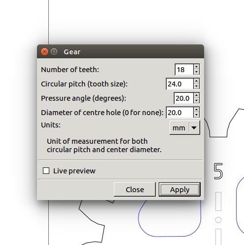

I usually work in Inkscape to create cut paths, and came up with a method based on its involute gear generator.
This can be found in the menu
Extensions -> Render -> Gear -> Gear
Set the number of teeth, I've used twelve for the crank cog and eighteen for the drive cog. The circular pitch determines how thick the teeth are, as long as it is the same for all your gears they will mesh correctly. Because they are being made from wood this needs to be fairly large compared to values we would normally use for metal or plastic gears, I used 24mm for this build. The other two fields can be left as default values.
The cogs produced will be the middle slice of our final gears. I've used eight slices cut from 1.5mm sheets, giving a thickness of 12mm for the final cog. To make the other slices it's simply a case of scaling this cog's height and width uniformly by twice the thickness of the material, ie 3mm per slice in this case. I made three progressively smaller cogs and four that increase in size. It's a good idea to number the cogs to make assembly easier. I'd also recommend rotating alternate gears when you cut them to cross the wood grain and make the final gear stronger.
The gear profiles produced are 'pixellated' steps between the layers rather than a smooth face. I had expected to need to file these flat but the cogs mesh well and run smoothly enough to drive the zoetrope without sanding or filing.

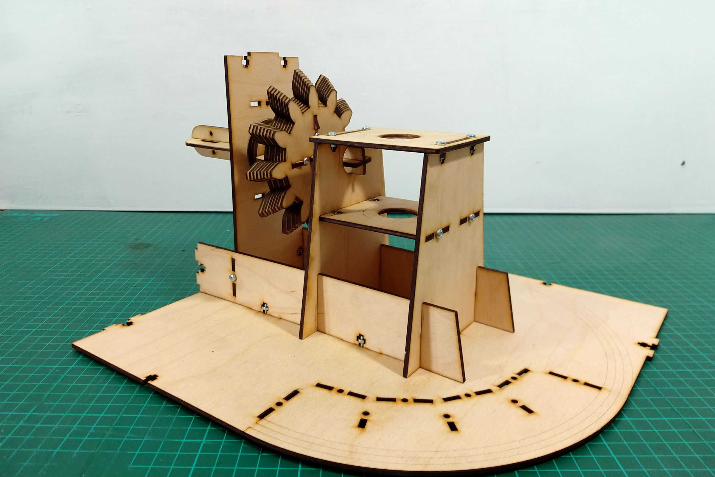

The support for the gears fixes to the base panel, the small cog fits between the two uprights to keep everything aligned. This part is quite fiddly to put together but forms a solid base.
  • Start with the frame that supports the larger gear. Use 8 10mm bolts to assemble this piece.
  • Slot this into the two long supports.
  • Fit the small cog and washers into the final upright and locate the tabs into the long support piece, use two more 10mm bolts to fix this in place.
  • Use seven more 10mm bolts to fix this structure to the base.
There are two more struts to add to the upright to fix it to the side panel, you'll need another four 10mm bolts for this, and three to secure the bottom of the side panel.

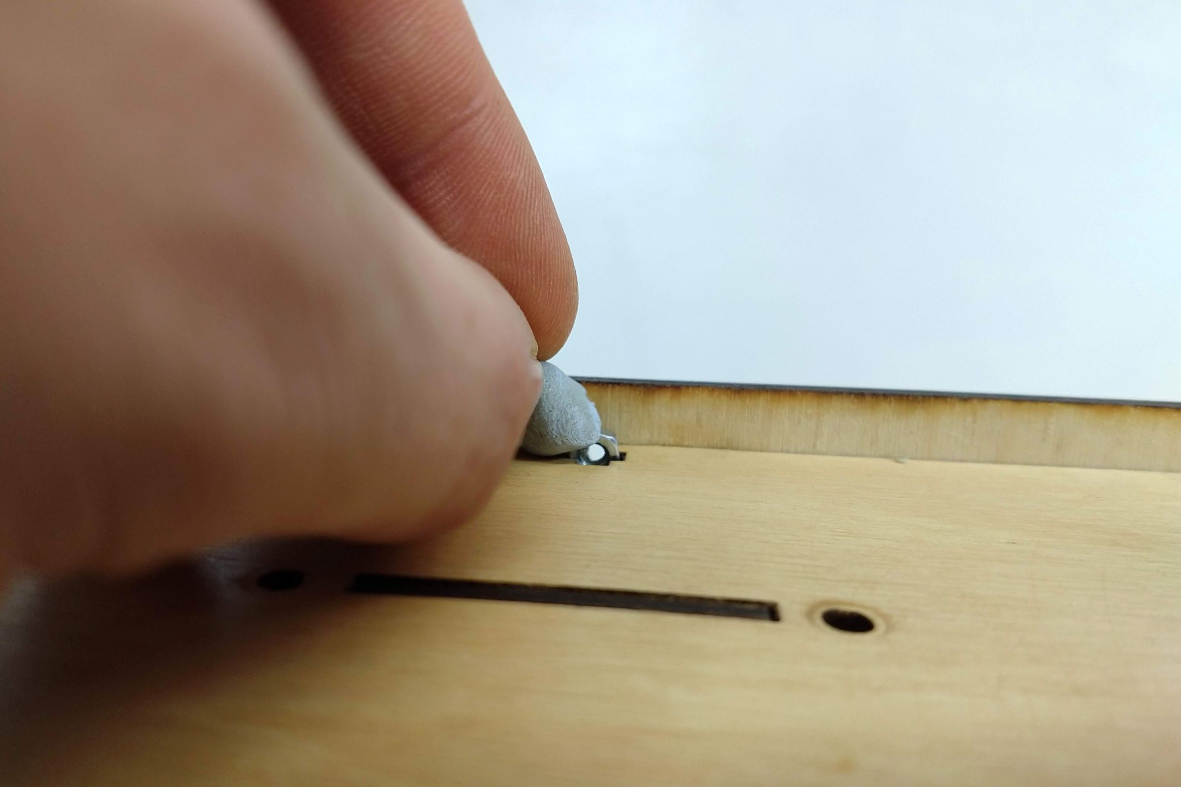

Painting the drum matt black will reduce the light reflected from the outside of the drum between frames. I found it easier to take out the bolts while I did this. I placed the drum inside a cardboard box with all the cracks taped up (to protect the carpet and wall) and spraypainted the drum using many thin layers, rotating the drum once one spray was dry and going over each area about 3 times in the course of many rotations. I also spraypainted the top brackets for the wheels, and the brackets that will hold the film in place (the film brackets needed turning once one side was fully covered and dry). Be careful with it whilst painting; since it has no bolts in it it's a bit more fragile.
