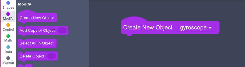

The first thing is to grab a Create new object block from the purple 'Modify' section and change the name to Gyroscope. This is going to be the top block of our code.

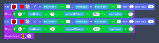

All that's left to do is slice the sides off, this needs two hollow boxes. Again I'm using maxRadius to set the dimensions so that this code works for any size of gyroscope. The width and height of the boxes aren't critical as long as they are bigger than the largest sphere. The length is set to be maxRadius
Because all shapes are created centered at (0,0,0) moving the hollow boxes by maxRadius/2 moves the outer edge to the centre of the sphere. percentageOfSphere tells us how far from the centre of the sphere we place the hollow boxes, to shave off the correct amount at the edges of the gyroscope. It specifies a percentage of the maxRadius, giving us a distance based off the size of the largest sphere.
Note the two minus signs for the second box to move it in the opposite direction.
The last step is to add another 'Create group' block to group everything together.
Move Y = (maxRadius/2) + ((percentageOfSphere/100) * maxRadius)Move Y = (maxRadius/-2) - ((percentageOfSphere/100) * maxRadius)
