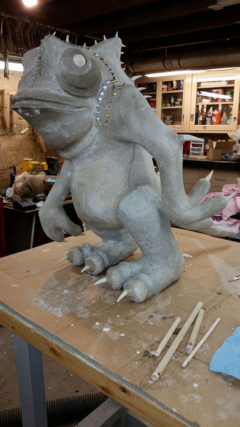

Step 27: Adding Paper Clay to the Figure
After completing the reinforcing step, the paper clay was applied to entire figure. I periodically used files, a Surform tool, and sandpaper to smooth out bumps, lumps, and overflow areas. The nice thing about using paper clay is that it can be filed and sanded after hardening.
Step 28: Smoothing the Paper Clay
The paper clay can be somewhat lumpy after being applied, so a paint brush and the papier mache liquid was used to smooth out the clay. You can see the difference in the surface by looking at the previous pictures.

Step 34: Accessorizing With Spikes
The Sculpey spikes were added to the appropriate locations. This was done by drilling into the paper clay at measured out positions. The holes were made from ¼” to ½” deep depending on the size of the spike or claw. The eyes were done in similar manner by drilling out a 1 ¼” hole to accept the Sculpey eyes.
Step 35: Accessorizing With Beads
The beads were also added using the hole drilling method. The holes were drilled to a depth of approximately half the diameter. This was done to better ensure that the beads would stay in place and because they had a hole through them. By embedding them a bit over half way deep the holes on both sides of the beads were covered.

Step 38: Custom Tools
After wracking my brain for a few days and searching for solutions online, I finally had the idea to make my own tools to make the texture for the skin. This was done by taking dowels of various diameters and drilling into the ends of each. The drill bits had a slightly smaller diameter than the dowels. This produced a cupped shape in the end with a thin wall around at the edge at the end.
Step 39: Adding Texture
I did a sample of the texture on the legs first. Starting with the largest dowel, I pushed the end into a thin coat of paper clay added for the purpose. Trying not to make any distinct patterns, the dowels were used going from largest to the smallest diameter. I then took a step back to get an overall view to determine any areas that looked sparse and added the size and number required to provide an irregular pattern.
