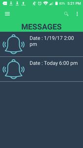

Step 12: Software : Android App
This is an custom built android app that communicate directly with the webserver that the Arduino Wemost put out . The app simply pull data from that webserver whenever there something new is being update. In the app, you can see doorbell notification and log with date stamp. In you click on one of these log you can see the picture that being taken and some more information such as whether the door bell was pressed or not .
