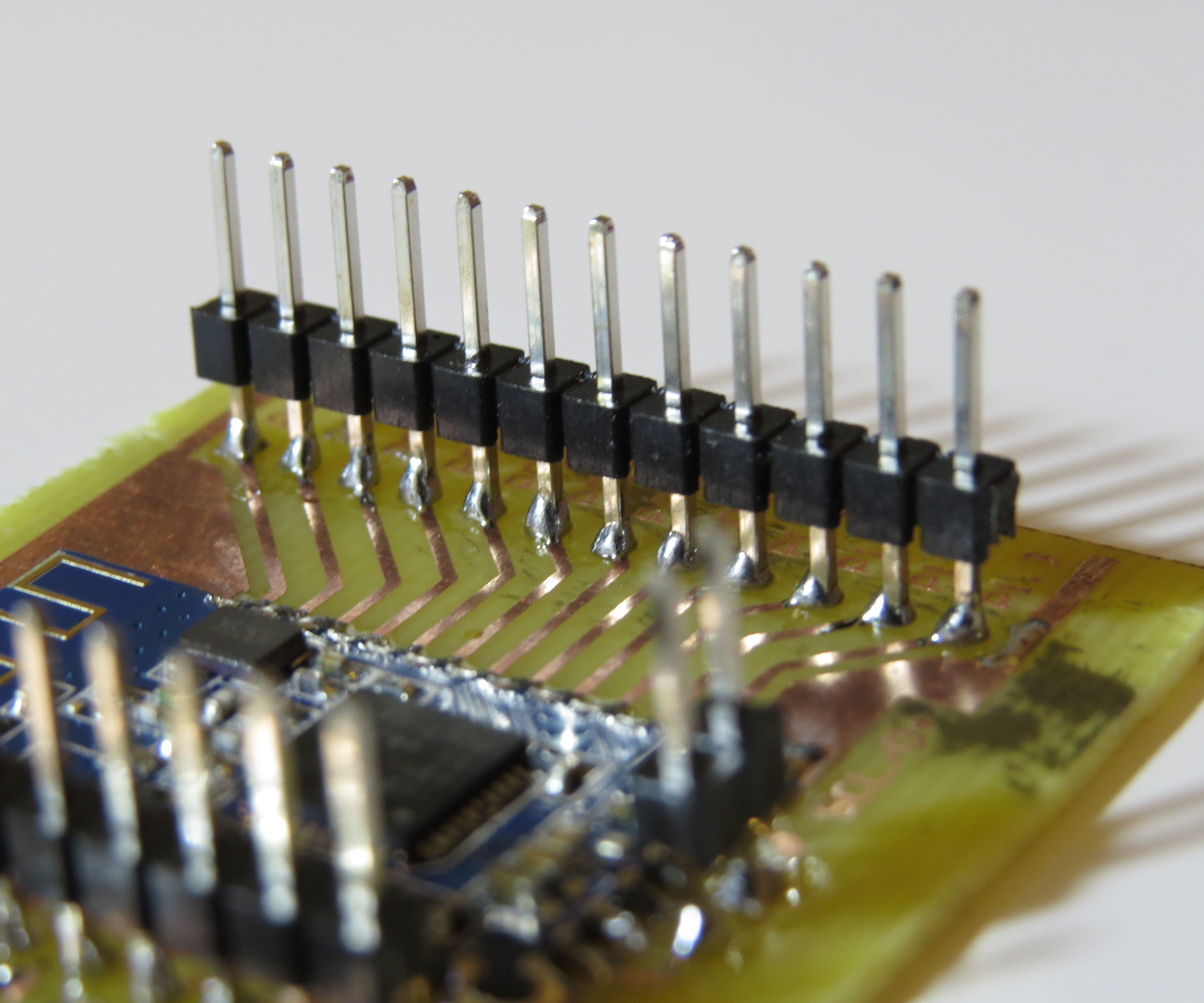

Step 3: Design the Schematic and PCB
As the T60's receptacle is a surface mount component with 0.5mm pitch, I decided to use SMDs for other components as well.
In this project, I decided to split the board into 2 boards:
- Arduino Micro mounting board
- Receptacle board with resistors and supporting ICs.
This allows future revisions of the boards to be more modular and may prove to be cheaper in the long run. For example, if I decide to add Bluetooth connectivity, I wouldn't have to use Arduino Micro for its USB capability anymore. I can use an Arduino Nano instead and only have to design the PCB on the Arduino side, knowing full well my receptacle board will work the same way regardless what microcontroller I decide to use.
I have included examples of my PCB layout, schematic and fabricated boards from Elecrow. The boards are double sided and fits within 50x50mm.
