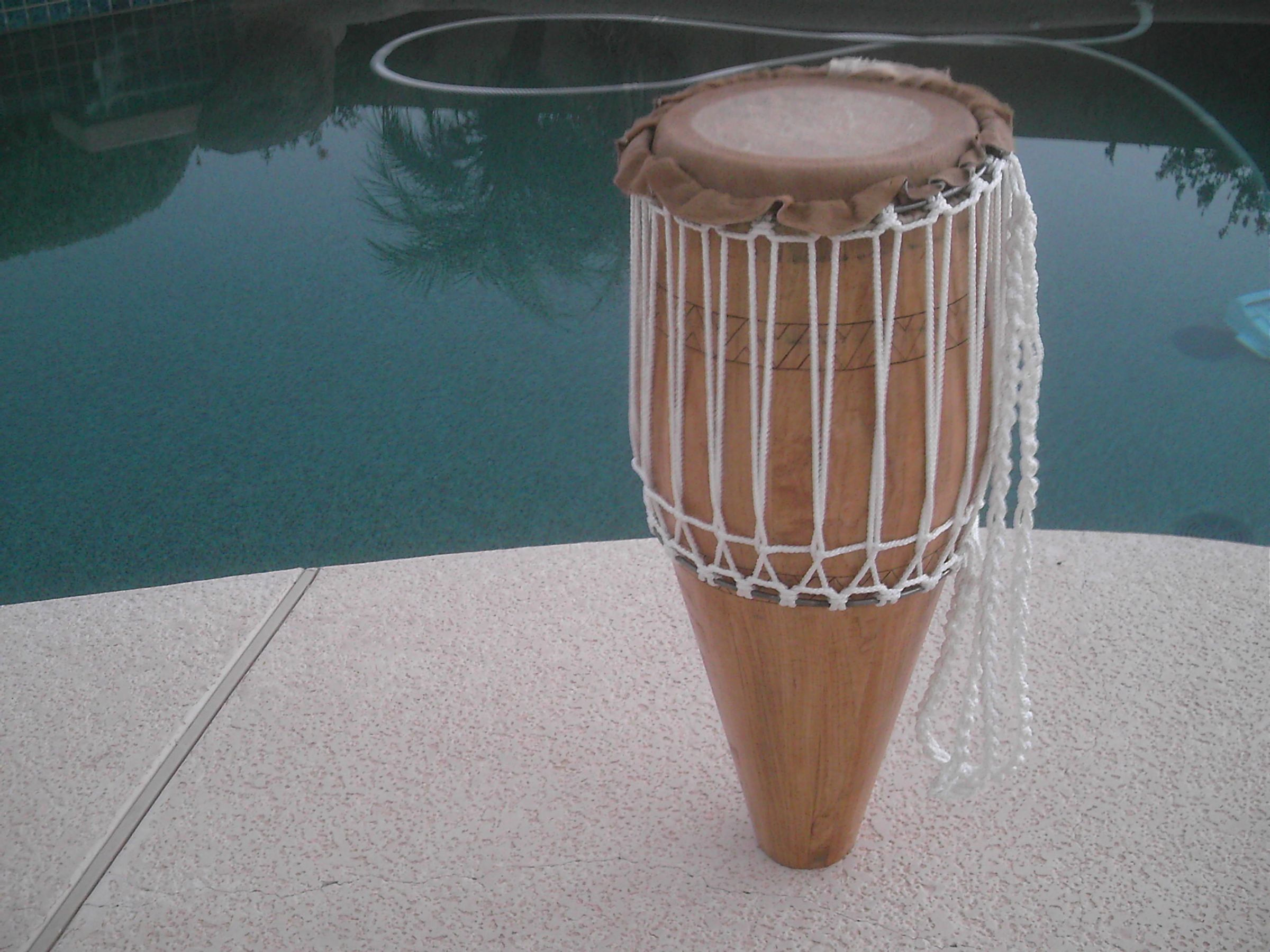

Get your hide and submerge it in room temp water for about 8 hours. During this time, get your rings and rope together. get one of your large rings and begin making loops around it like these pictures illustrate.
Place the other large ring under the drum.
Loosely thread the rope under the bottom ring and through the top loops, and do not yet tie the ends together.
when the hide is done soaking, lay it flat on the ground and put the last ring in the middle. punch small holes around the edge (for ease of application) using a hammer and screwdriver on wood and thread small rope through it, cinching it up after you are done.
Now push the hide/ring combo through the vertical ropes on the drum and over the mouth of it. Get rid of the small rope and wiggle the skin and rings down a bit to get some room between the lip and the rings. tighten the verticals, and tie the ends together and let the skin dry un-tightened. it is normal at this point for the skin to suck into the drum as it dries, it will tighten up when the pegs are added.
After 3 days of drying, drive the pegs between the bottom ring and drum shell and tighten the skin. The atabaque is ready to be played!
