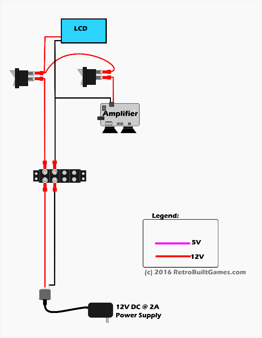

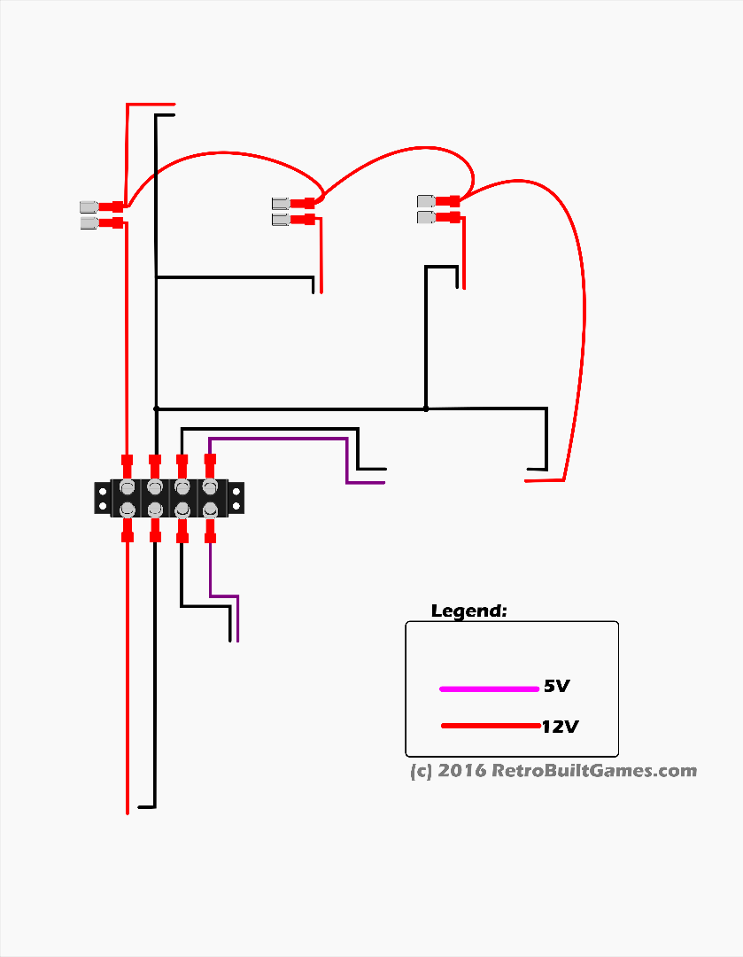

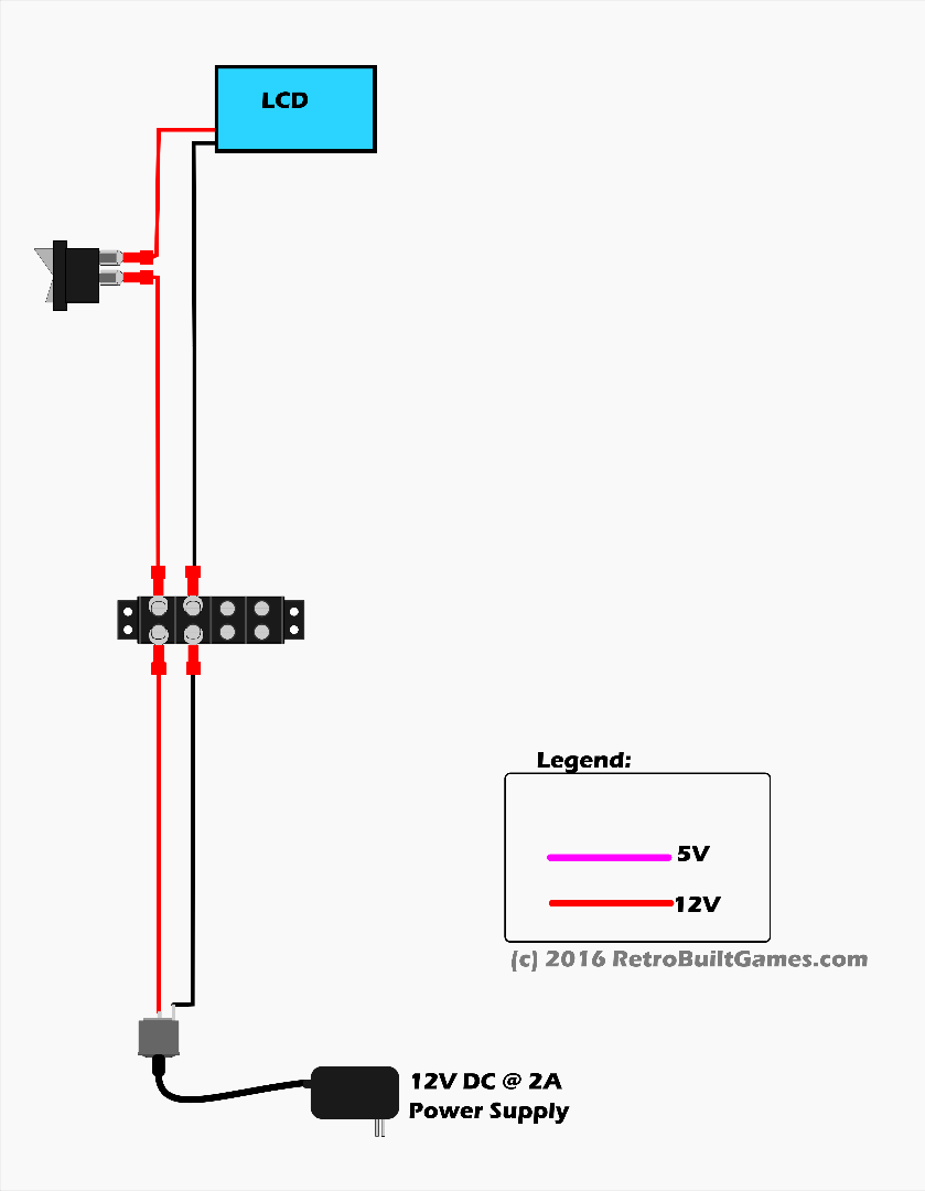

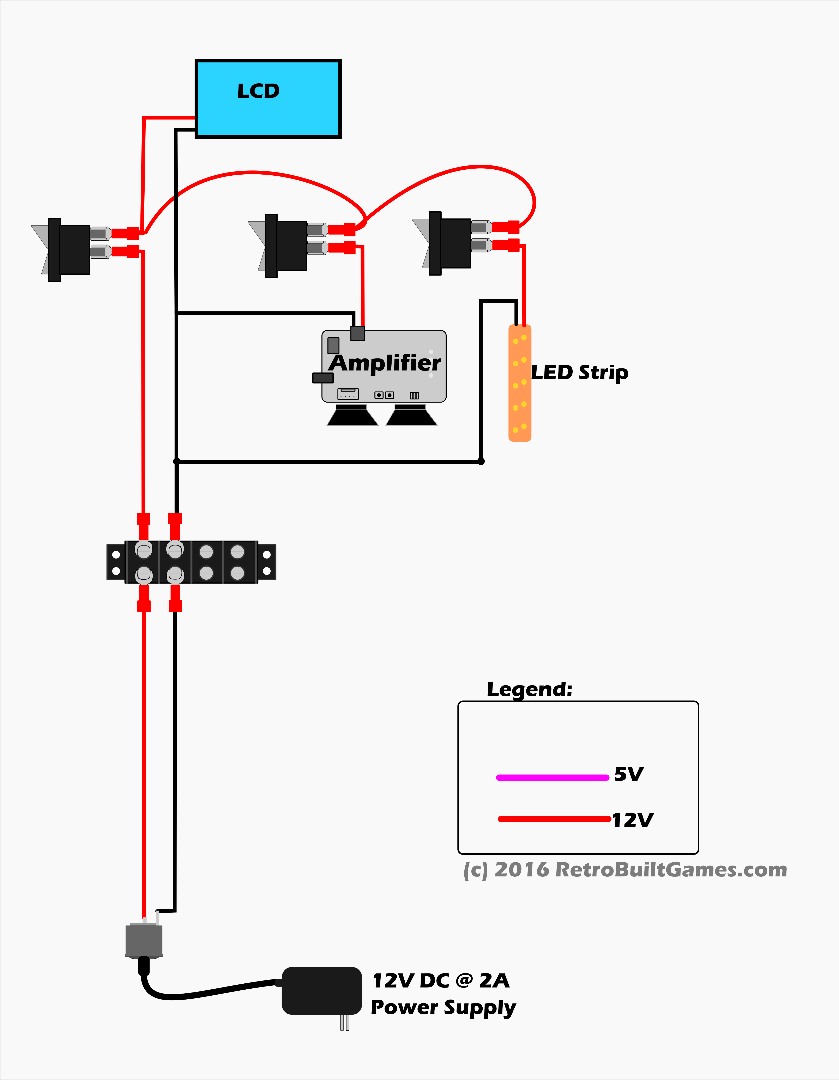

Step 3: Power Circuit Details
I came to realize after publishing the video that the power circuit can be tricky to wrap your head around. You can most definitely simplify it by just using one power switch. However; if you prefer my over-engineered solution, I provided a step-by-step breakdown of how to build the circuit. The first picture is the wiring 'harness' that I made which controls power for the entire cabinet. This is what needs to be fabricated and connected to the individual components. I break it down into steps starting from power going into the machine and add each part (LCD, amp, backlight, game PCB) one-by-one.
Breakdown:
We are running the following on 12V:
- LCD
- Amplifier + speakers
- LED Backlight
The game [JAMMA] board is powered by 5V, therefore we require a step-down converter to drop the main voltage 12V to 5V.
