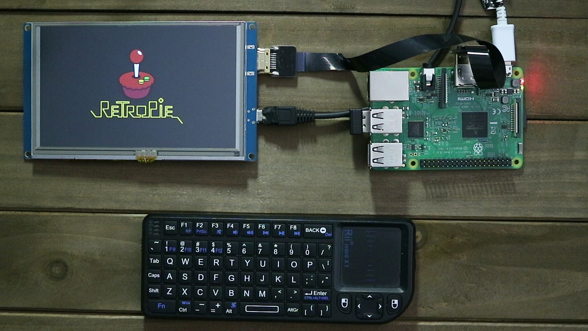

Starting out, the Pi will need a keyboard, mouse, power source, a micro-SD card, and a display (I'm using my 5" LCD display). These will be needed to set up the Pi initially. Once you have all those items, the next step is to download an operating system for the Raspberry Pi.
Raspberry Pi, Screen, and Keyboard/Mouse

With my setup, the first thing I noticed is that the RetroPie interface doesn't completely fill the screen. So that's immediately one thing that needs to be tweaked. But we'll come back to that later.
Retro Pie on 5" LCD

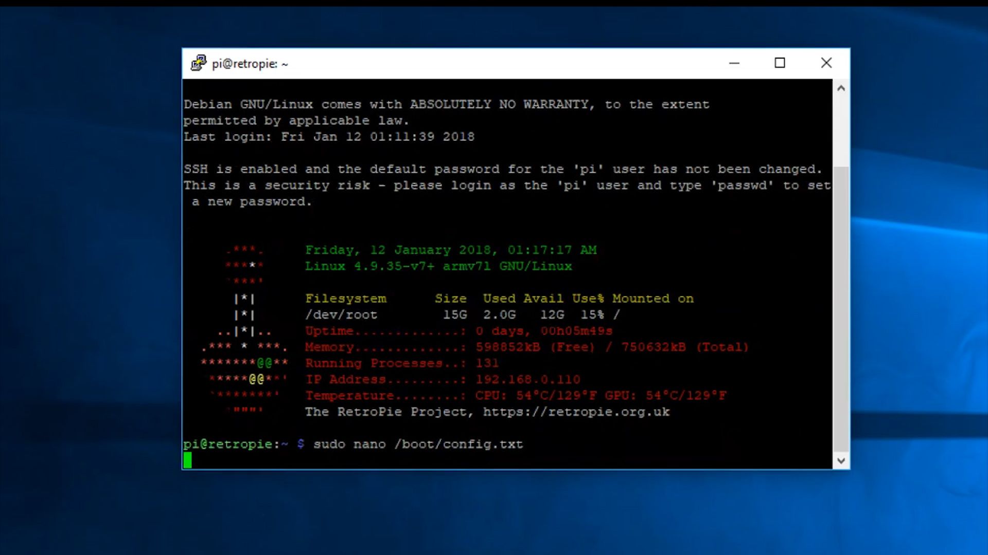

To remotely connect to the Pi from a different computer, you need an SSH client installed. On Mac and Linux you can use the terminal. On Windows, you can download Putty.
Putty SSH client
Then simply connect using the Pi's IP address that we recorded in the previous step.First on the docket is fixing the display issue on my 5" LCD. To do this, we need to edit the boot/config.txt file adding (or uncommenting) these entries:
sudo nano /boot/config.txt

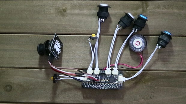

This wouldn't be a worthy arcade project if we didn't have a joystick and arcade buttons. So after purchasing some, the trick was figuring out how to connect them all to the Raspberry Pi. Luckily, I stumbled across this Raspberry Pi Arcade Bonnet from Adafruit. It's a simple board that sits on top of your Raspberry Pi GPIO pins and allows you to connect several different buttons, an Analog or digital joystick, and a speaker. The Arcade Bonnet was crucial in making this project work.
Adafruit Arcade Bonnet
So I connected my joystick, 6 buttons, and a speaker to the Arcade Bonnet. It's a lot to explain here, but if you need more information on how to connect your Joysticks and buttons to the Arcade Bonnet, you can visit the documentation page on Adafruit's websites.
Components For Arcade Bonnet
Then with the Pi turned off, I connected it to the Pi's GPIO pins. After turning the Pi back on, we can now connect to it via SSH to install the Arcade bonnet software and make everything work. To get the buttons and joystick working, just run this script that pulls the installation files from the Adafruit github repository.

Bonnet With Components Attached

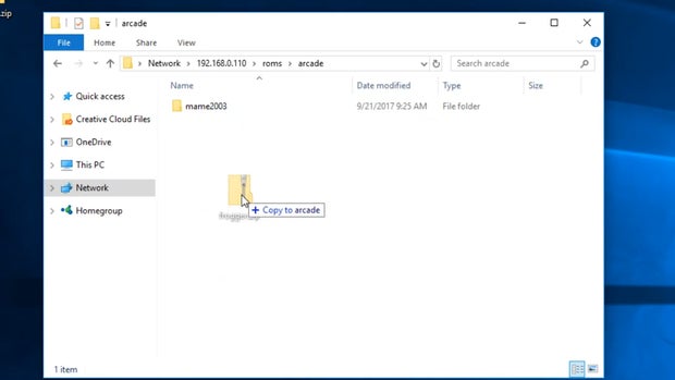

Now how do you get it on the games on the Pi? By default, the RetroPie has file sharing enabled. So you can basically type in the Pi's IP address into Windows file explorer to see the folders to put the ROMs. Where you put them depends on the type of game you're adding. Arcade games go in the MAME folder, Nintendo games go in the NES folder, Playstation games go in the Playstation folder, etc. Once you have your ROMs copied over and you reboot your Pi, you should now see your games in the RetroPie menu.
Copying ROM's To The Shared Folder On The RetroPie
When launching a game, you may or may not experience an issue with the controls not working. This is because, in some instances, you have to set up the controls specifically for each emulator you're using. For instance, if you're playing a Nintendo game, you have to hit the buttons equivalent to "Select + X" to access the emulator settings where you can then map your controls and save them. For arcade games, you can hit the button equivalent to the "Tab" key (may require plugging in a keyboard temporarily) and then map the controller buttons to the right commands.
