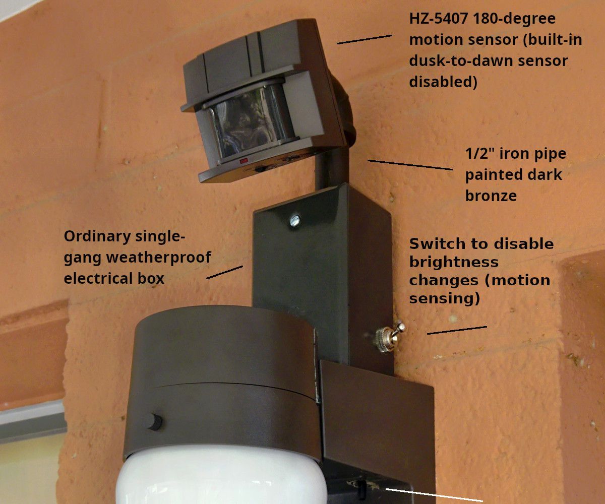

Step 10: More Ideas...
"Dual-Brightness" (ambient and security light)
My ideal fixture would have both motion-sensed full brightness and dusk-to-dawn ambient light. I figured out how to do that with any fixture! (Photo 1). See my other Instructable: Dual-Brightness Motion-Sensing Patio Light.
