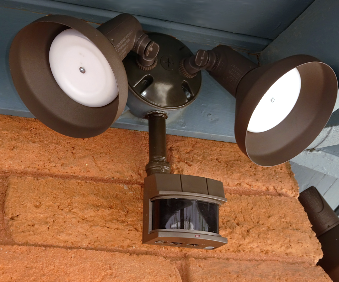

Introduction: Dual-Brightness Motion-Sensing Patio Light
This project converts an inexpensive motion-sensing lamp fixture (Heath-Zenith HZ-5610, which is off until motion is detected) to have "dual brightness" functionality (both low-level, ambient illumination and full-brightness when motion is detected).
Both levels of illumination are adjustable with dimmers. The motion-sensor can also be disabled to have persistent (unchanging) lighting of the space (e.g., during a party). Simply flip the toggle switch, turn up the idle dimmer to have brighter light. When you're finished using that space, return the idle dimmer to the no-motion ambient level, and flip the toggle switch to have dual-brightness motion sensing again.
Hint: Much of this project's effort centers around fitting components into the HZ-5610's unused space. However, if you look at the wiring diagram (photo 5), you can see how that circuit will work with any light fixture. You'd have to use a larger electrical box to hold all the components (instead of trying to fit some inside an existing fixture). This project would be much shorter/simpler if that's all I did (but, I wanted to reuse the fixtures I have, which have some space built into them for circuitry.).

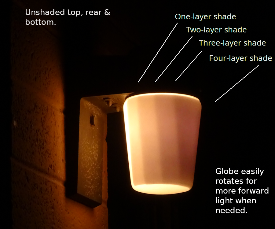

I was motivated to do this project after making my HZ-5610 fixture more Dark Sky friendly using a paper "shade" inside the globe, reducing the amount of forward light (making the fixture more back-lit against the house, more down-lit; less harsh to view).
At that time, I had the idea to create this "dual brightness" functionality using the HZ-5316 motion sensor which has a built-in "DualBrite" feature. Later, I discovered that sensor isn't made for LED bulbs (if it does work, the bulb and/or sensor isn't expected to last long, according to Heath-Zenith).
That caused me to think about how I could create such functionality using basic parts:
- An ordinary motion sensor (no built-in dimming, just on/off switching)
- A dimmer for idle brightness (I used two dimmers for separate control of both the idle & motion-sensed brightness)
- A relay (to switch between idle & motion-sensed current to the bulb)
- A dusk-to-dawn sensor (to control the whole thing. The motion sensor has a dusk-to-dawn sensor too. I disabled that by painting over it.)
- A toggle switch to make the fixture always-on (no dual-brightness interruptions when using the space for a purpose).
It's actually quite simple (image 5), and much more functional than Heath-Zenith's product (which hasn't even been updated to work with LED yet). The most tedious part of this project was trying to conserve space by using the gutted fixture to hold something. As mentioned previously, you don't have to do that. You can put all these parts in one box, and use any fixture.
The 2nd dimmer (to control active, motion-detected brightness) is overkill. With any motion-sensing fixture, that brightness is controlled by the bulb you choose. But, in the spirit of the Dark Sky initiative, I thought it would be beneficial to have a dimmer for that mode too. (If you use a bulb that's a little too bright, you can tone it down.).
You can't buy a light with this dual-brightness functionality (let alone this configurable). Best of all: this can be used with any fixture.
Fixture: Heath-Zenith HZ-5610 (photo 6). This fixture comes with its own dusk-to-dawn & motion sensing electronics. After removing that, it has some interior space to hold some of the components, allowing the smaller (single-gang) box I used. You could use a double-gang box (or Cantex #5133705 4x4x2" tall box, or their #5133709 4x4x4) to hold everything. You don't have to put the dimmers inside this fixture.
This wiring will work with any fixture. Ultimately, the only thing that matters is the "hot in" (from the house wiring) and "hot out" (to the bulb). Everything else can be isolated (into one box) and used with any fixture.

Step 7: [BOX] Install the Motion Sensor
The HZ-5407 motion sensor is attached to the box using 1/2" pipe (photo 1). This pipe can be black-iron (must be painted or it will rust), galvanized (doesn't have to be painted, but if it is: you need special paint), or PVC ("nipples" are called "risers" for in-ground sprinklers; there are PVC elbows. If you paint PVC, you'll need Krylon or something made for plastic.).
1. Preparation
I used black-iron pipe painted with Ace satin "dark bronze" (color: 225A160) enamel. I tightened the elbow onto the nipple before painting, and cleaned the surface with acetone. I painted two coats, waiting a day between coats. I touched up after installing. (I used brush-on paint because spray would be messy, especially for touch-up.). I used an enamel primer. But, I don't think it's necessary. (I waited a day for that to dry too.).
I used a 3" long nipple. You can use any length. My first attempt (a prototype) used what's called a "close nipple," which is 1" long & continuously threaded. (A close nipple is used to connect two fittings without adding any significant length). See photos 2 & 3 to see what that looks like (compared to my 3" nipple, which adds 2" of length).
I used an 1/2" EMT locknut (against the box) so the pipe won't rotate. Pipe thread is tapered, EMT is not. Therefore, I had to "swage" the locknut onto the threads (before painting). I put the nipple in a vice, and used channel-lock pliers to rock the locknut 1/8-turn forward/backward, increasingly forcing it further, causing the threads to expand, and allowing the locknut to go further up the threads (which allows the nipple to thread further into the box. You don't have to swage the locknut all the way to the top of the threads. But, you probably want to swage it some distance. After you tighten the elbow onto the pipe, which you should do before painting too, then you can see how far the nipple threads into the box. When you see that, you may want to swage the locknut further. For example: if you're just a quarter turn from the elbow facing forward, you might swage another 1/4 turn.).
Hint: I removed this locknut before painting. After painting, I had to put the nipple back into the vice to thread the locknut up to where it needed to be. That marred the paint. In retrospect, I think I would leave the locknut on the nipple while painting.
I did not use a locknut against the elbow. (The elbow and nipple are tapered threads and will tighten to each other without the need for a locknut.).
2. Install
I wrapped the end of the motion sensor's wires in electrical tape so they would feed through the pipe easily (photo 4). This also protects the strands from fraying. It was easy to push that through. (If you used a longer nipple, you might have to use some string to "fish" it through.).
Important: Feel around for sharp edges & burrs inside the elbow & nipple. (Sometimes elbows can have casting residue inside. You can break it off with a screwdriver.). It's best to do this before tightening the elbow & nipple together. A sharp edge or burr could damage a wire's insulation. (If you really want to be cautious, wrap the entire length of wires in electrical tape. But, I think that's overkill. If you can't feel anything very sharp, you'll be fine. But, it's easier to fix any problems earlier in this step.)
I used a screwdriver to keep the elbow straight while I cinched the locknut down against the box (photo 5).
Hint: The force you apply against the elbow is in the "untightening direction." That's a good reason to tighten the elbow onto the pipe very tight (before painting). You can also let paint get into that joint between elbow and nipple. That will help lock it together too.
3. Install box onto fixture
This was discussed in Step 3 (when we drilled a 7/8" hole in the top of the fixture). It's time to complete that step by attaching the box to the top of the fixture. (If your fixture is exposed to rain, revisit the warning in that step.).
Plug the rear hole:
If your box came with a threaded hole in the back (most do), it should have come with a plug for that. (If it didn't, you can buy 1/2" EMT plugs at the hardware store). It's important to plug that rear hole to keep bugs out.
WARNING: Plugging unused holes is also an important part of the "weatherproof box" being weatherproof. In my case the fixtures are protected from rain. If your fixture needs to be weatherproof, I have numerous warnings through this project about that topic.

1. Shade
Take a look at my instructable for a neighbor-friendly patio light. In that project, I made a "shade" inside the globe to limit how much light shines forward. This makes it easier on the eyes, and more Dark Sky friendly. The idea is that more of the light goes straight down or backwards to reflect off the house's wall.
In that project I used 4 sheets of paper cut increasingly narrower for "steps" (or feathering) on the sides. I'm now using 6 sheets of paper without any side feathering. This creates a more "full-cutoff" effect, with almost all the light coming from the bottom and back-lit wall (photos 1-3). It's very pleasant (photo 4). I'm also using a slightly brighter (350 lumen) bulb.[1]
Note: The camera doesn't have the range to capture what this looks like in person. If you saw it in person, the patio would look about as bright as the photo depicts. But, the fixtures would really look as soft & muted as the individual closeups. They aren't as glaring as that patio photo.
