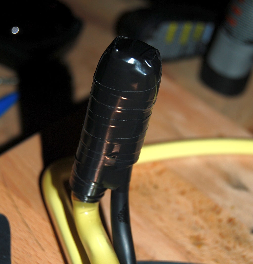

As neon tubes are very fragile I attached rubber pads to the metal mounting arms to provide a softer surface for the glass. I also added another neon support arm at the top of the sign as the neon was only being held at the bottom. At this point I attached the transformer wires to the neon tube and capped them with the neon wire protectors that came with the transformer to protect the unit from the high voltages. I then wrapped the caps in black electrical tape so that everything was sealed properly.
Using a medium gauge copper wire I attached the neon tube to the rubber coated support arms. The copper wire gives the neon some wiggle room as it is being handled so there is less stress on the glass tube. The copper sheet was only attached in the center so I used some felt furniture pads on each corner of the copper sheet to make sure the "lighting gap" was consistent all of the way around the letters. The final step was to plug the sign in and see how it looked!
