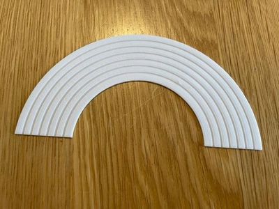

Step 1: Print the Parts
The files can be found here: https://www.thingiverse.com/thing:4871829
I've also attached them to this Instructable, in case there are issues with Thingiverse.

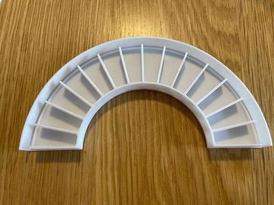

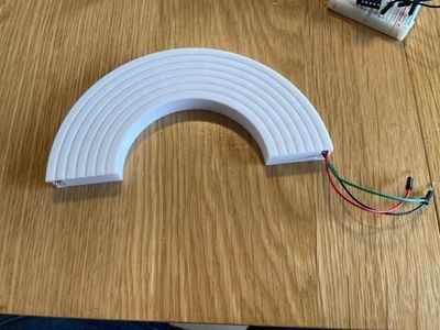

Step 2: Insert Neopixels
If you printed the entire rainbow, you should be able to insert the line of Neopixels into one side of the rainbow, and the strand should be easily pushed around the curve. Once fully inserted, the pixels should line up with the inner sections of the rainbow. Personally, I would solder on the leads you need for connections at this point, before you push the Neopixels in.
As my printer isn't great at bridging, it was easier for me to print the two parts of the rainbow separately, insert the strand all at once, and glue the top of the rainbow onto it.

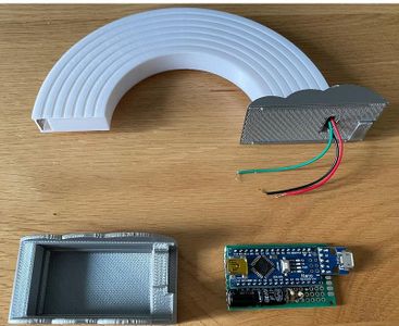

Once complete, I then glued to top of the hollow cloud into position.
Step 3: Wire Up the Arduino

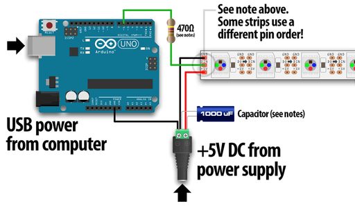

The hollow cloud is large enough to accept an Arduino Nano into it. I mounted mine onto some prototyping board, along with the capacitors needed for the Neopixels, and a micro USB socket.
I've attached the wiring diagram from Adafruit - the only difference, is I had to put 3 100ohm resistors in place (I didn't have any 470 ohms, and my capacitors are two 47uF's.
Also, I've attached the code I used. The eagle eyed will notice it's the simple_test code from Adafruit, I've just commented out the lines which don't give he rainbow effect. I could have written nice new code, but why reinvent the wheel?!?!
