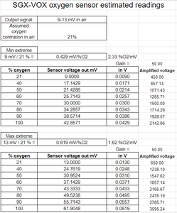

This instructable shows you how to build a breakout board for amplifying the output signal from the SGX-VOX oxygen sensor with 50x gain to allow the sensor to be easily used with an Arduino or similar microcontroller, or even just using a standard volt-meter. The voltage output from the SGX-VOX is very low, around 9mV - 62mV across the whole range from 21% oxygen to 100% oxygen. The voltage scales linearly with oxygen concentration.
You will find attached:
- our schematic
- a screenshot of our calculated estimated voltage readings for different oxygen levels
- some datasheets for the SGX-VOX

You will need to calibrate the background level for your sensor as there is a tollerance for this value from the factory. To do this, upload the code and open serial monitor. The values on the left will be a voltage level reading in mV and the values on the right will be the oxygen concentration percentage (these will be wrong before you calibrate). To calibrate the background level take a reading of the sensor voltage in mV in normal background conditions (which you can assume to be 21% oxygen in normal air) and update the "#define backgroundReading" with your new background voltage reading. Then re-upload the code.
I have attached a look-up-table with the theoritical voltages you should get at different oxygen concentrations for reference.
