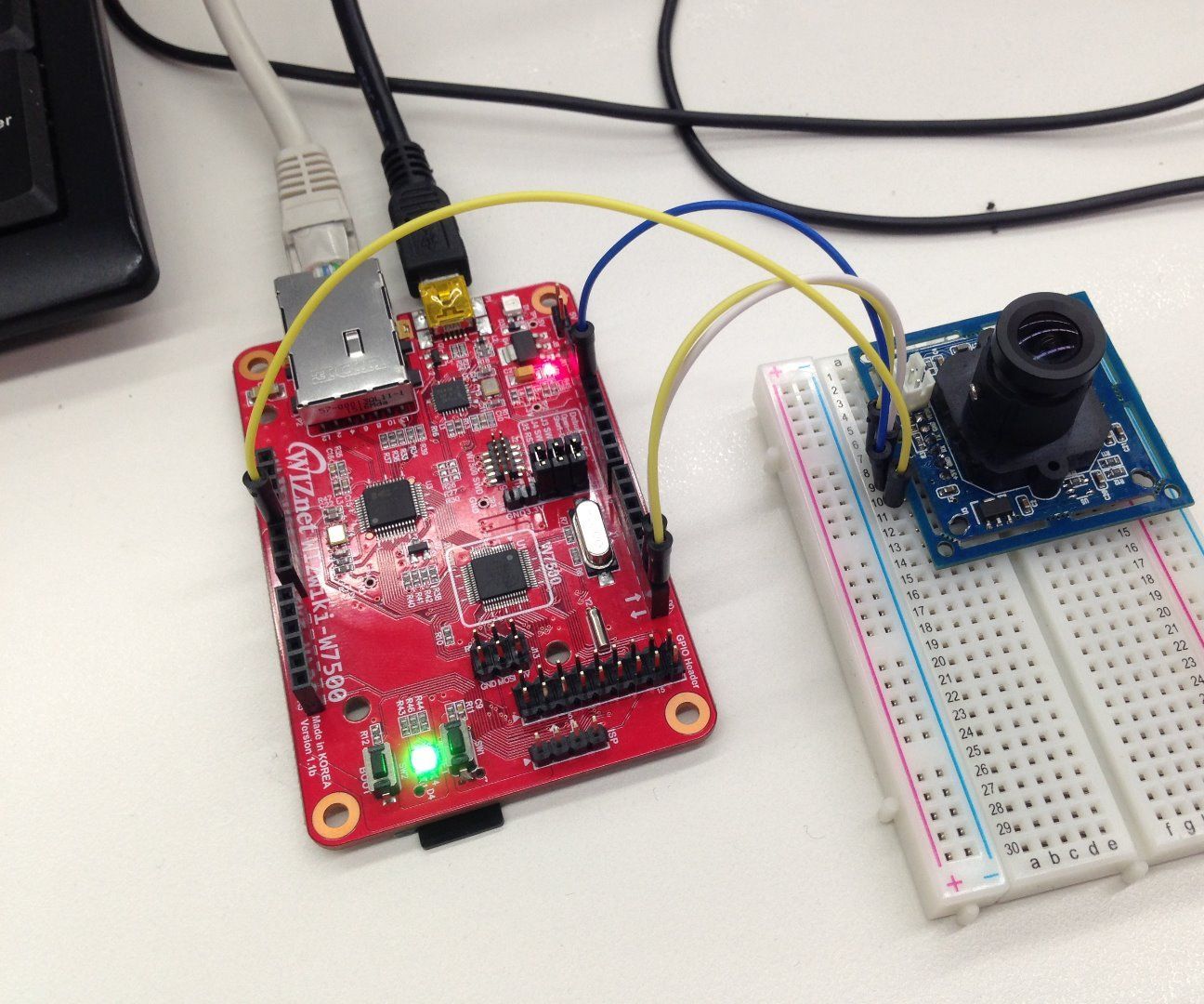

Picture shows you how connect WIZwiki-W7500ECO and one LED only.
You can duplicate other LEDs ealily.
To control these LEDs, LED must be connected with and port of WIZwiki-W7500P.
DigitalOut LED1R(P5);
DigitalOut LED1G(P6);
DigitalOut LED1B(P7);
DigitalOut LED2R(P15);
DigitalOut LED2G(P16);
DigitalOut LED2B(P17);
DigitalOut LED3R(P18);
DigitalOut LED3G(P19);
DigitalOut LED3B(P20);
DigitalOut LED4A(P25);
DigitalOut LED5A(P22);
DigitalOut LED6A(P23);
DigitalOut LED7A(P24);
DigitalOut LED8A(P21);
DigitalOut LED9R(P27);
DigitalOut LED9G(P28);
DigitalOut LED9B(P29);
DigitalOut LED10R(P26);
DigitalOut LED10G(P31);
DigitalOut LED10B(P32);
As you see. it is very simple.
For connect LED, any port is OK.
And you can check that which port is used for LED control in source code as below.
And I used DC motor and Just connected with Li-ion Battery and Switch.
So it will run with full speed when SW is ON.
