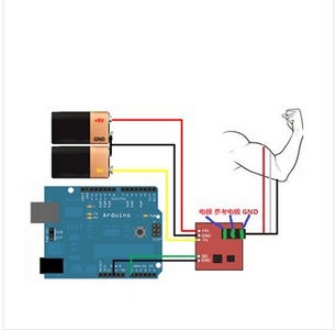

Step 3: Muscle Sensor V3.0 (spark Fun Sensor)
Muscle Sensor hookup diagram for Arduino Uno. Two 9 volt batteries are connected together and grounded on the sensor. The positive and negative ends of'the batteries are wired to +Vs and ʹVs respectively. The sensor is also grounded on the GND pin on the Arduino Uno, and the SIGN hookup gets connected to ANALOG IN'1 There is a hookup on the Muscle Sensor microcontroller that allows the electrodes connected t 'the bicep to be connected to the sensor.
