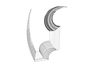

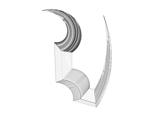

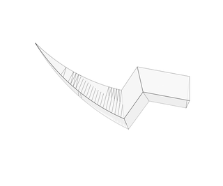

Step 2: Print the Files
Start by downloading all the files. You will have to print each attached file once, except for file "Circle.stl" which has to be printed three times.
My printer bed is to small to print the whole Triforce in one go, so I decided to separate it into two pieces. After all the pieces are printed use a plastic primer, to ensure that the paint later sticks to them properly.
