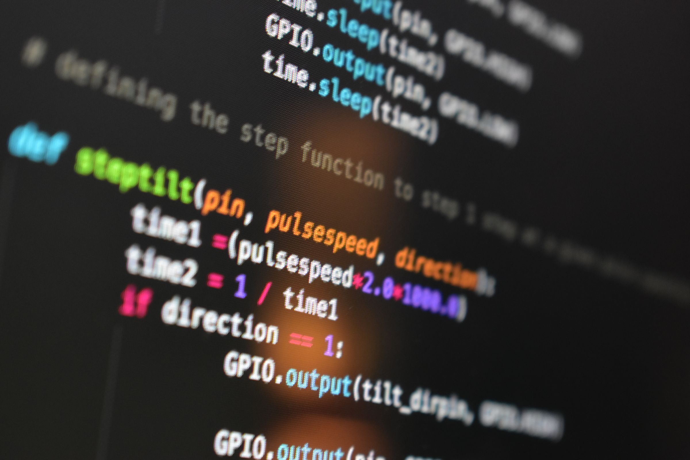

Step 7: Setting Up Raspberry Pi and Installing Python Programs
You will need to download pantilt.py and 2motors.py and put it on your Raspberry Pi in the same directory. Then to start the timelapse you will have to run 2motors.py. A GUI should appear and this is where you input your settings for your time-lapse. At the moment the GUI is not fully finished but I will be adding more things soon. Feel free to write your own programs if you want to add any other functions that are not included in the GUI.
