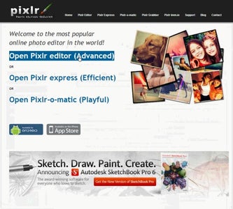

So I started by navigating to Pixlr the only way I new how, through the Instructables photo editing contest page.

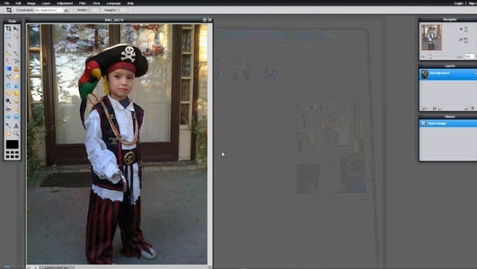

Clicked on "Open Image from Computer" and browsed to an image I shot a couple of years ago, keeping with the theme of Halloween. If you're a parent, you probably have a few of these kicking around on your hard drive.

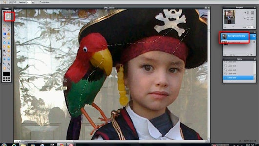

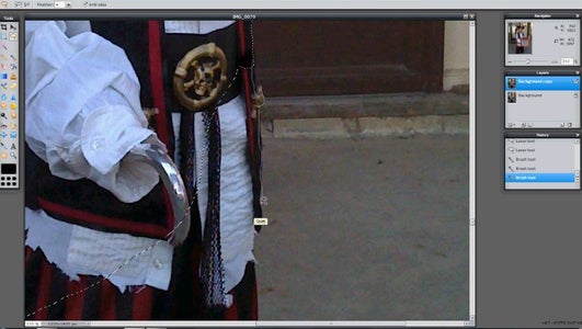

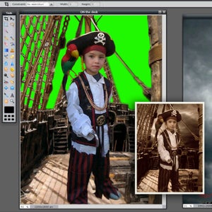

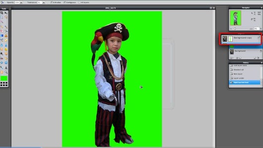

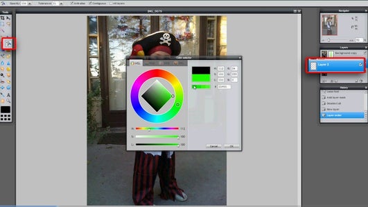

The background layer had a lock on it, so I just made a copy of the layer to start working on it. I want to cut out my son out of the picture and place him on the deck of a ship. My first job was to start cutting or masking, my preferred method. As far as I know there are basically two ways to get rid of unwanted pixels in an image. One is to simply use the eraser tool and lose them forever or there is using a layer mask a.k.a. alpha to hide them. The reason I like the second approach is it is non destructive. If you decide later on you want some part back, you edit the layer mask to bring that part back into view.
To create a layer mask you need to select an area you want to mask, There are a number of tools you can use to do this and some are better suited than others, given the situation. In this demo I will use a few techniques to demonstrate what I mean.
For smooth organic shapes I try the Lasso tool (L) in Freehand mode. An important step here is to adjust edge quality of the selection tool. You can feather (soften) the edge by a given number of pixels to reduce the cutout look of your shape. This can be found, top left part of the screen just under the menu bar. Take care to not over do this, often it only takes a value of around 2 to 5 pixels depending on the resolution of your image or how “in focus” the object you are masking is. By holding down the (Shift) key a small + appears beside the tool, this means you are adding to your selection. This is good to know because it allows you to select pieces at a time which I find easier than trying to snake your way around the whole perimeter. If you stray outside of the area you intend to mask you can deselect parts by holding the (Ctrl) key. Look for the - to indicate you are subtracting from you selected area. When you feel you have made your selection, there are three ways I know to make a layer mask. First, make sure that the layer you want too apply the mask to is selected in the layers window. Then either:
a) Click "Layer" on the menu bar then on the drop down menu click "Add layer mask"
b) Right mouse Click (RMC) on your selected layer, scroll down and click "Add layer mask"
c)Click on the icon at the bottom of the layers window, second from the left (Grey dot on white rectangle)
There you have it, that little rectangle that appears beside the layer thumbnail indicates your layer has a mask. By clicking on that rectangle, highlighting it with a red frame, you can add to or subtract by using a brush to add and an eraser to subtract.
Which is exactly what I did to touch up any spots that I missed with the lasso tool like the legs of the patriot.
Note to the Pros out there: I am aware I have been a bit messy on the masking I just wanted to get it done and not have it drag on I the video.

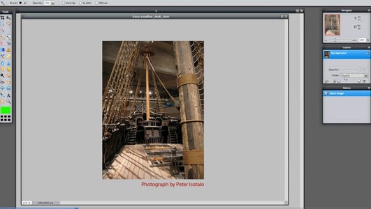

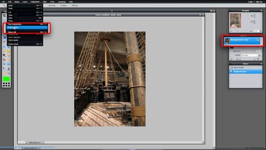

Step 3: Reducing Extreme Perspective or Getting the Ship Into Shape
Photograph by Peter Isotalo

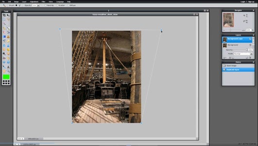

This picture of a ship deck was taken with a wide angle lense that has emphasised the perspective and created some lens distortion. Once again starting by making a copy of my background layer I will try to straighten things out a little. Clicking on “Edit” in the menu bar and scrolling down to Free Distort...I used this tool to widen the top part of the image to reduce the distortion. I’ll admit it is not perfect but in my opinion it helps.

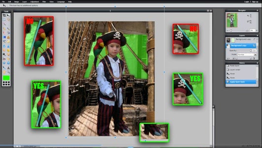

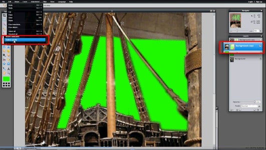

Step 4: Masking Part 2

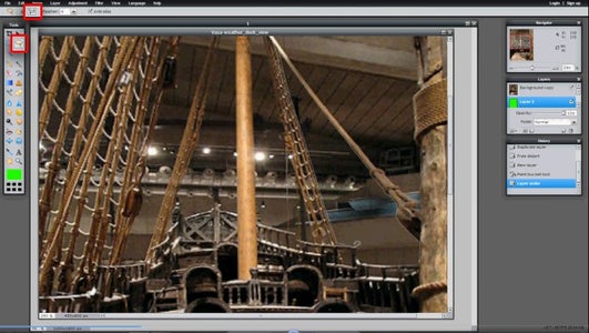

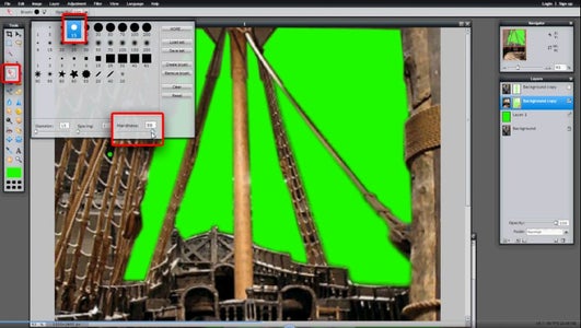

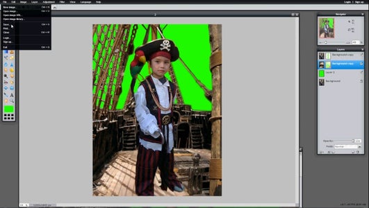

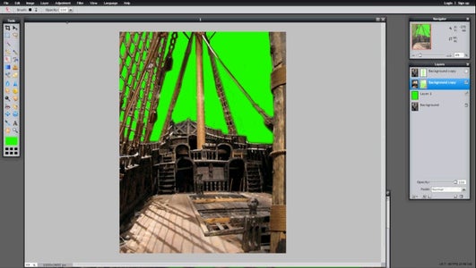

Now we’re back to masking. Once again our objective is to get rid of unwanted parts of the picture. In this case it is the inside of the museum. Now unlike the smooth organic shapes of our little pirate the rigging on this ship is very strait. To make a selection around the rigging I will once again choose to use the lasso tool only this time have it in “polygonal” mode. With this I can click point to point to make my selections. I will also feather the edge of the selection. Once I have made the layer mask, I will go in and pick out the inside of the rigging using the eraser tool adjusted with the same softness as the lasso tool.
That completes the masking part of this demo

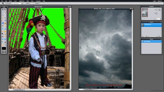

Step 5: Inserting an Image - the Skyâs the Limit
Stormy Sky 3 Image by Pelleron-Stock

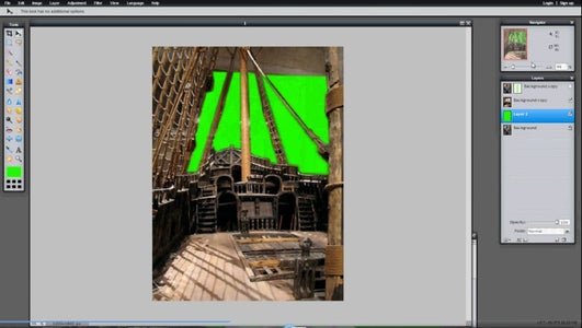

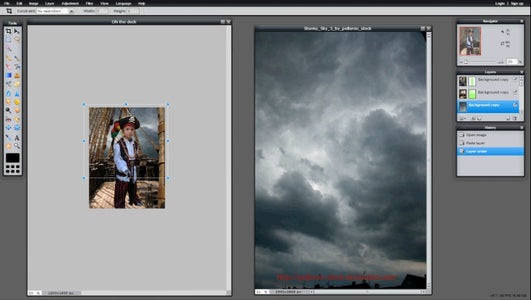

The next thing to do is to put in the sky. To insert an image from one document to another, all you need to do is have both documents open side by side:
1) Select the window with the image for copying.
2) Click and hold on the layer you want to insert into your other document.
3) Drag and drop it onto the window of where you want it. (look for a + to appear to confirm this is going to work)
Or
you could while you have the layer you want to copy and move Click Edit, Select All (Ctrl+A)
Edit, Copy (Ctrl+C)
Select the window of your target (where you want to copy/ move it to) and Edit, Paste (Ctrl+V)

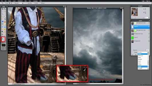

It may be necessary to rearrange the order of your layers. Do this by simply dragging them around in the layers window. The order in which they are visible is as you would expect, Top layer is foreground and bottom layer(s) are behind in the background.
If you are just working with random images you will find it necessary to resize the images with the Transform tool
(Edit, Free transform) this will bring up 8 little squares, adjustment handles, around your image. You may have to zoom out a little to see the handles on larger images. By clicking and dragging these handles you can adjust the size of the image. To maintain the aspect ratio of your image, press and hold down the Shift key. This is most important when scaling people or images of things that are use to looking a certain way.

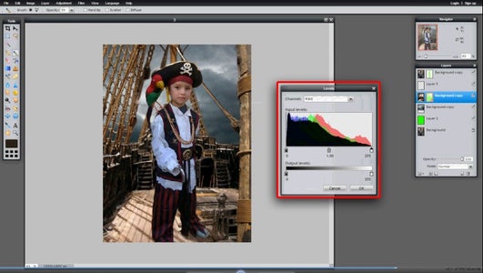

With the sky in place I wanted to get rid of the floating effect by placing a shadow under the foot. In the layers window I add a new layer place under the kid and over the ship deck. I selected the eyedropper tool (i) picked a shadow colour down by the foot and started to paint in a shadow. Looking at the existing shadows as a guide for direction and intensity as well as if they are sharp or soft. My painting looked a bit opaque and I was loosing the detail below so I changed the layer mode to Multiply to turn my paint layer in to a transparent colour that is added to the layer below. This let's the detail for below to show This is done by clicking on the bottom left corner of the layers window to bring up a small adjustment box for "Mode" and "Opacity". Both of these are powerful was to change the look of a layer and deserves it's own Instructable.

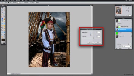

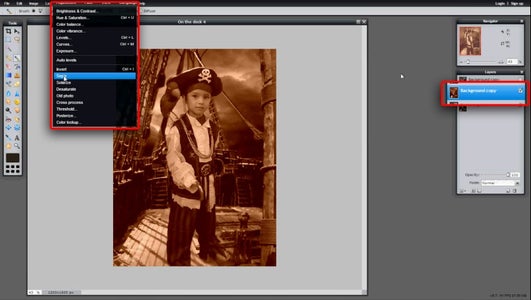

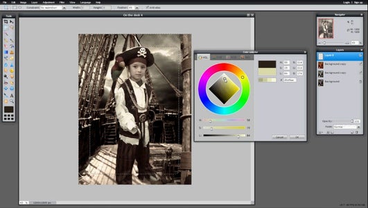

Step 6: Applying Adjustments

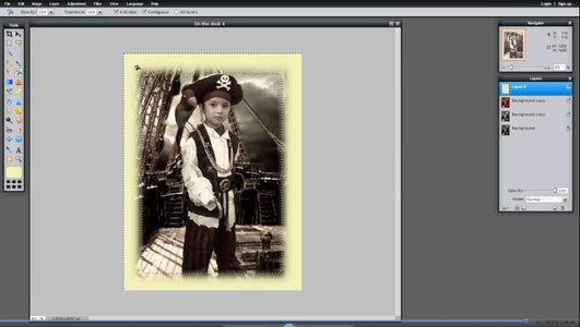

Have fun Click Adjustment, sepia or old photo. I thought the sepia was a bit strong so I placed it above the "Old Photo" layer and reduced the opacity as mentioned at the end of the last step. I was able to get something I liked by adjusting the opacity of both the top two layers.
Note: I tried "Pixlr express" and "Pixlr-o-matic" it after making this tutorial... way more fun to use either of these than to do what I did.

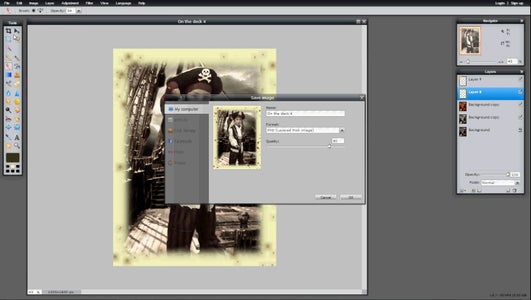

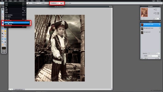

Step 7: Creating a Soft Frame Border and Foxing
So in these steps I want to make a soft frame boarder and add a little aging.
1) Click on the rectangular selection tool sometimes called the marquee tool.
2) Adjust the feather control to around 40 pixels for this fairly low res picture that will seem pretty blurry.
3) Make a selection imagining the line I draw is going to be mid blur on the soft or feathered edge.
4) Click Edit. Invert Selection.
You are ready to make your soft edge matt or boarder.
5) Create new layer on top all the others.
6) Pick a colour and use the Bucket tool to fill in the boarder.

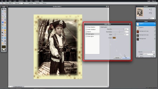

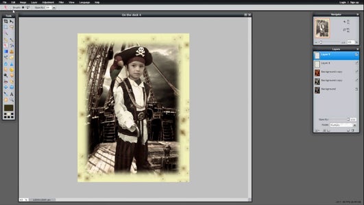

To age this picture I thought I would add a little foxing so create a new layer on top.
1) select the paint brush and open the brush properties by clicking on the downward triangle in the upper left next to the word "Brush"
2) Pick a brush and adjust the spacing to about 100 (in the middle) and start making dots.
you may need to adjust the size and softness of your brush. repeat this step a couple of time to get different size dots around your image.
3) Open the layer's style box (3rd icon on the left in the bottom of the layers window) and add some brown "Outer glow" adjust to taste.
Remember to save.
