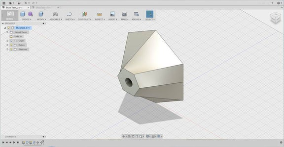

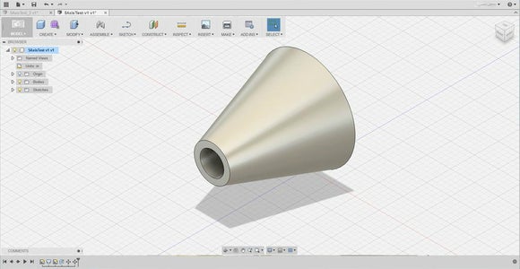

Step 1: Export Your Model
Check the location of your Z-axis. Remember on the OMAX Waterjet, your Z-axis is your height, even though Fusion and Inventor's default is to use the Y-axis as height.
  • Right click on the title
  • Hit Export
  • Export model as an IGES file
    • .igs and .iges are the same
When modeling for the OMAX I use the Front plane as my top, as seen in the photos. Then it will export with the correct Z-axis.

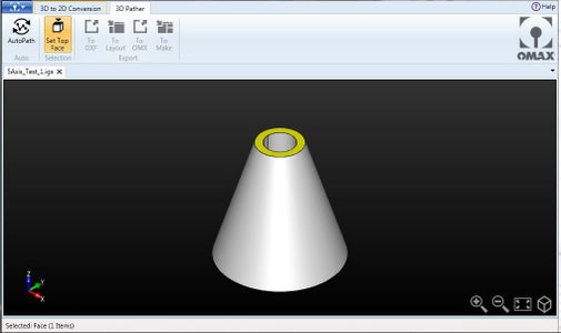

Step 2: Generate Toolpaths in IntelliCAM
At the Pier, IntelliCAM is only on the OMAX computer.

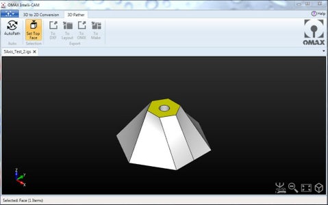

  • Open IntelliCAM
  • Click on the Blue tab in the corner to open your IGS file
  • Go to the 3D Pather tab
  • Select Set Top Face
  • Then click on the top face on your model
    • This is a good time to check if your top face and Z-axis are in the same direction, if not go back to Fusion/Inventor and change it

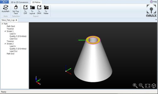

  • Then click on Autopath
    • Your model should look like mine with different colored lines and a dialogue box on the left of the screen
      • You can scroll over the commands in the box and it will highlight the correlating lines in the model
      • Check all the lines to make sure you understand what each one is doing
  • Send to OMAX Layout

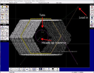

Step 3: Cleanup Toolpaths in Layout
You possibly could skip this step and go straight to OMAX Make, but I would not do this unless advised by Shop Staff.

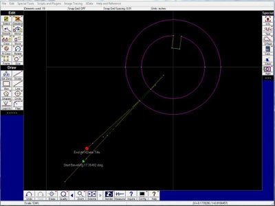

In OMAX Layout you can check your path more closely, add tabs, and change your traverse lines. All three of these will help prevent collisions.
  • Add your Tabs
  • Change solid green traverse lines to dashed green Heads up traverse lines
  • Check your lead in and make sure it is far enough away from your model

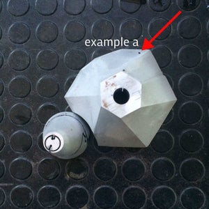

    • The pierce on the lead in will not be at an angle and could possibly pierce your piece, see example A
  • Check your paths to make sure they make sense

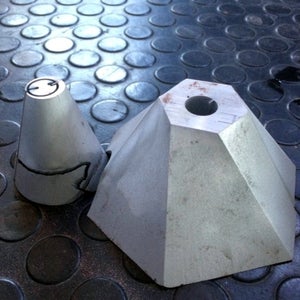

My two examples look drastically different. That's because the cone shaped one is a constant angle while the other example is changing angles the whole time. That's why there is a bunch of numbers all around it. If you check out the cone example it is easy to see the data numbers telling the angle and you can see the cut and traverse lines.

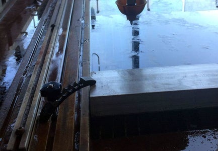

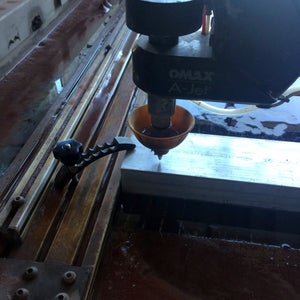

Step 6: Secure Material
Your material must be tightly secured down. The angled and lateral forces are different and stronger with the A-jet than your standard waterjet cutting.
Give yourself sufficient room to prevent collisions. Keep about an inch away from clamps and rails.

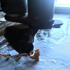

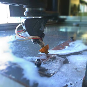

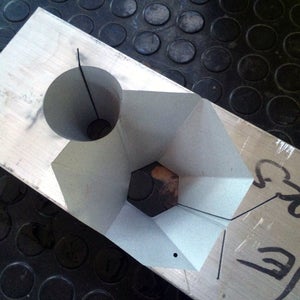

Step 9: Do a 5-Axis Cut!
Ready, set, go!
Don't forget to turn on the Pump and Garnet.

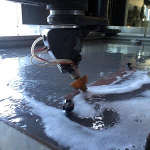

Watch out for the piercing, if your material is thick it will shoot up and spray wildly until it gets all the way through the material.
Stay close and be ready to hit pause if anything seems weird.
Hit the emergency stop if anything seems scary or you're in danger.
Put out the Danger Wet Floor signs if needed.
If you look at my samples you will see I started the second one too close to the first and it not only cut into the cone but spun it around. The narrow part of the cone was at the top so it was fine but if it had been upside down it possibly could have been shot up.
