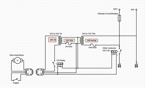

Step 2: Schematic
The schematic is actually quite simple.
Two 12V automotive batteries, wired in series, generates the necessary 24V high amp positive/negative inputs/outputs for welding.
The circuit uses a high amp contactor (think of it is a very high amp relay; 150AMP in our case). These are now used extensively in electric cars; it was through an electric car parts website that I found one.
The contactor is controlled through the trigger of the spool gun, so that the tip isn't always hot, as was the case in Tim Anderson's original Instructable. This makes the whole thing much safer, as it's very easy to fumble around with the gun when using heavy welding gloves.
There is also an additional relay that controls the drive motor in the spoolgun that advances the welding wire. The motor in the Lincoln spoolgun is labeled at 24V, but the contactor I ordered uses a 12V coil. The manufacturer of the contactor that I'm using, Gigavac, has 24V coil models, which would simplify the circuit, but the supplier I ordered from only offered the 12V coil model. I also like the idea of using the two voltage-regulator power supplies so that the voltage to the spoolgun motor would be regulated. Possibly overkill, but better safe than sorry.
The trigger is basically the 12V+ supply to the two relays (contactor and drive motor relay). These two relays supply 24V+ to the spoolgun tip [unregulated] and the drive motor [regulated]. The tip is supplied raw/unregulated 24V+ 150amp from the batteries, and the motor is supplied with a regulated 24V+ 3amp from the secondary power supply.

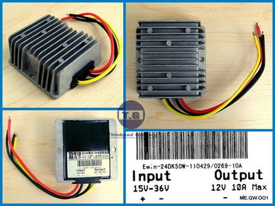

I wanted a regulated voltage for the spoolgun motor as it's designed to be used in an AC/DC welder, where the voltage is regulated, and I also wanted regulated so that the speed of the wire motor would be constant.
I looked on ebay and found some very nice regulated DC-DC power-supplies:
These provide rock stable voltage to both the relay coils, and the drive motor. Probably overkill, since the voltage coming from the batteries would not have a great range (causing speed fluctuations in the drive motor), but I wanted something very dependable.
I mounted both of these onto a spare heat sink that I had, that clipped nicely into the inside of the toolbox, but if you don't have a heat sink, you can mount them directly to the metal sidewall of the toolbox, as the current draw isn't anywhere near their limits, so even just the heat dissipation through their case should be fine.

For welding the charge is used in two different configurations. When using a flux-core wire, the "ground wire" actually carries a positive charge, and the spoolgun carries a negative charge. When using a shield-gas mig wire, the polarity is opposite. Having the terminals allows changing the charge to the "ground wire" and the "conductor block" with ease.
The negative wire (within the toolbox) connects directly from the SB175 input connector [-], to the final negative terminal, as all the various switching is done via the positive wire. The positive wire connects from the SB175 input connector [+], to a 150amp circuit breaker which is connected directly to the contactor with a small piece of steel that I cut to size. The contactor then connects to the final positive terminal. I made the mistake of attaching the contactor to the toolbox before figuring out the best placement to accommodate the 1/0 gauge wire, so you'll see in the picture that my positive wire from the supply connector has an S curve to it, because trying to size the 1/0 custom cable length to the exact size would have been tricky. If I had waited to mount the contactor in the last step, I could have had more flexibility in sizing the cable lengths.
- Note that the supply for the two regulated power supplies is connected prior to the 150amp circuit breaker (smaller 10g wire shown in image 3), as they are supplied through their own 10amp fuse.
