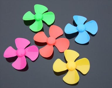

The polarity of the generator varies along the direction of rotation or the direction at which the propeller rotates. With the action of wind, some propellers are designed to rotate in clockwise direction and some are designed to rotate in anticlockwise direction.
Simply Connect the terminals of the propeller coupled generator to the respective positive and negative terminals of the voltmeter and conduct the test.
Just give a blow manually to the propeller such that it rotates. Simultaneously observe if the voltage read on the voltmeter for a positive or negative voltage.

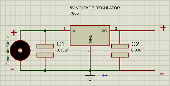

Step 3: Schematic/Circuit Diagram and Working
The total Circuit involved with the wind generator is shown in the above pictures.
Whenever the fan rotates, an emf will be generated. The output voltage is not constant. But in order to charge our phones, a constant voltage is necessary. For that we need to use a voltage regulator of constant 5v output. Even the output current through the voltage regulator is limited to 1Amps, and thereby making this wind generator a 5W energy source. There may be noise in the output, to mnimise the same, shunt capacitors are use. You can either use two 33 micro Farad capacitors or two 22 microFarad capacitors across input to ground and output to ground terminals. Finally a micro usb cable that is compatible with your phone can be connected to the output terminals to charge the phone.
You can either rig up the components on a perforated board or can even design a simple PCB, etch it, place the components and mount it on a DC generator directly.

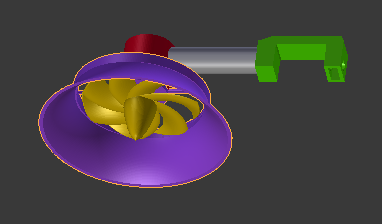

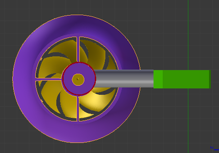

Step 4: 3D Printing (You May Skip This Test If You Dont Have a 3D Printer)
Some parts of the above 3d structures are used from ready made models available on Thingiverse and assembled by me through Blender software. You must edit the parts because the size of your DC motor may vary with that of mine. The main intention of myself uploading the 3d files are to provide you an access to the files used for my idea. I have attached the blender files in case you need to edit it. If you have used a motor with an outer casing of 25mm diameter., then you can go ahead and print all the parts separately and join it as shown in the above figures. I have used fevikwik to join all the parts.
After assembling everything, place your generator in the cylinder and attach a fan to it from the front. Since I have made a PCB, I have directly mounted the PCB to the generator. You can even attach the rigged up perforated board circuit which was shown in the previous step to the output of the generator and complete the working model.
