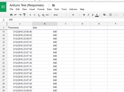

Lets get right into this. I was logging temperature of a room to an Excel sheet via Serial.print commands, then importing CSV files and yada yada. I couldn't get to the data unless I was at home, and also I had to leave my computer running in order to log the data. I needed a better way to log temperature (or anything for that matter) and be able to access it from anywhere.
Google Docs is a great free service that fits the bill perfect. There are tons of tutorials showing how to do this HOWEVER they are all out of date due to Google changing things up on their forms. So I am here to re-write everything I learned to help you get started and logging real time to the internet. You will need: Arduino R3 Ethernet shield (probably can be done with a YUN or WiFi, but I used Ethernet.) ** I added a screen shot of my dashboard which displays all the data that I am collecting. This is all based on 3 temperature sensors.**

I have attached my very simple code to run this example. You will find a section of things to be edited. This code will send responses to the form you created in the form of data. You will see google then creates a spread sheet and logs all the responses WITH time stamps! Use this to create data logs of temperature, light levels, humidity, motion whatever you want!
