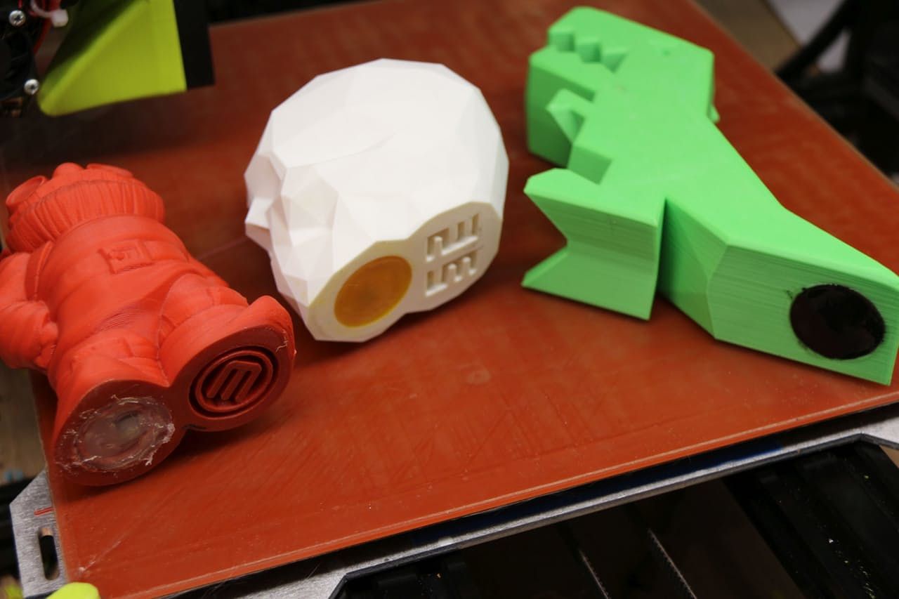

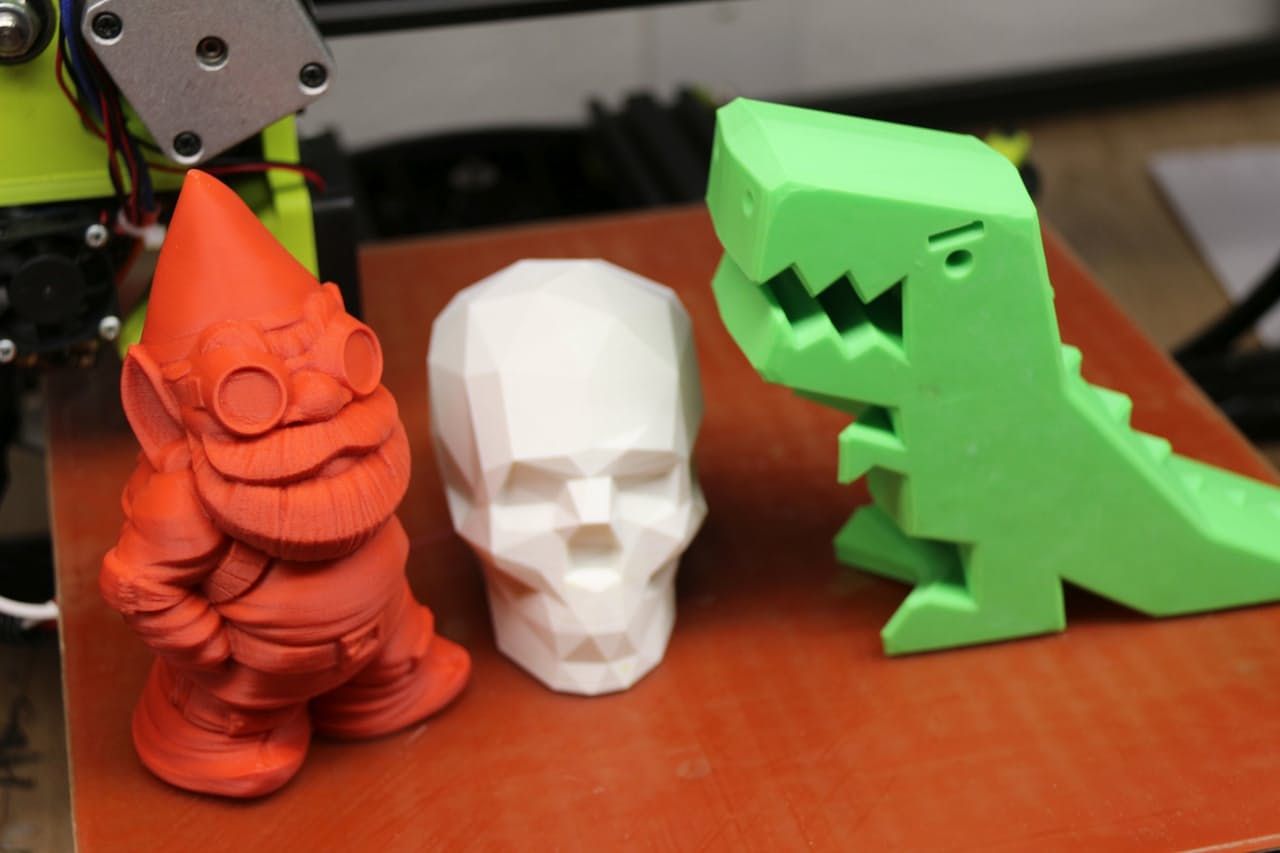

I 3D printed three designs to epoxy the RFID tags to. This way I can set them in the flower garden outside my house.
I printed a Makerbot Gnome, a Low Poly Skull, and a Robber Rex, all from Thingiverse.
For the Makerbot Gnome I tried using hot glue for the tag but it did not flow well. For the Low Poly Skull and Robber Rex I used epoxy mixed with toner from used laser printer cartridges. This flowed a lot better and left a nice finish.

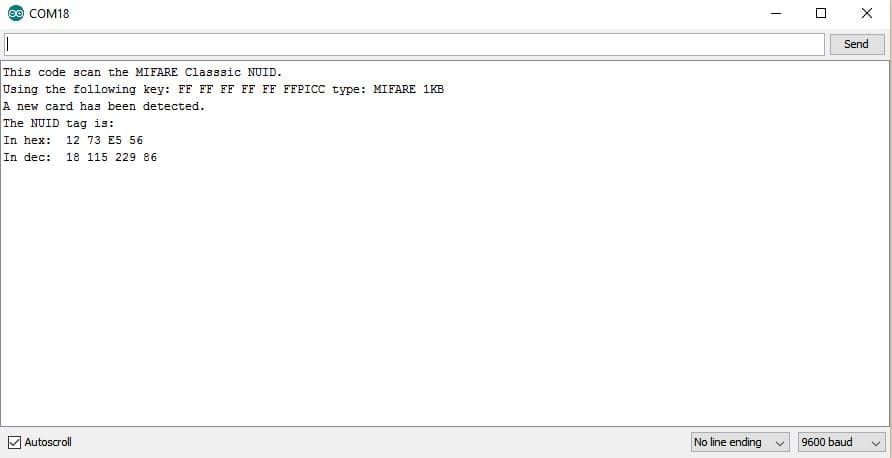

We are going to need the UID of the rfid cards we will be using. In the Arduino IDE we will need to add the MFRC522 library that can be found athttps://github.com/miguelbalboa/rfid
Once that is installed open the ReadNUID example in the sketch folder MFRC522. Upload that sketch and then open a serial monitor. When you scan a tag you get this displayed.
You see that our hex code is 12 73 E5 56, write that down and now scan two more tags. (Your tags will most likely be different, but for this guide we are using the results I got.)
