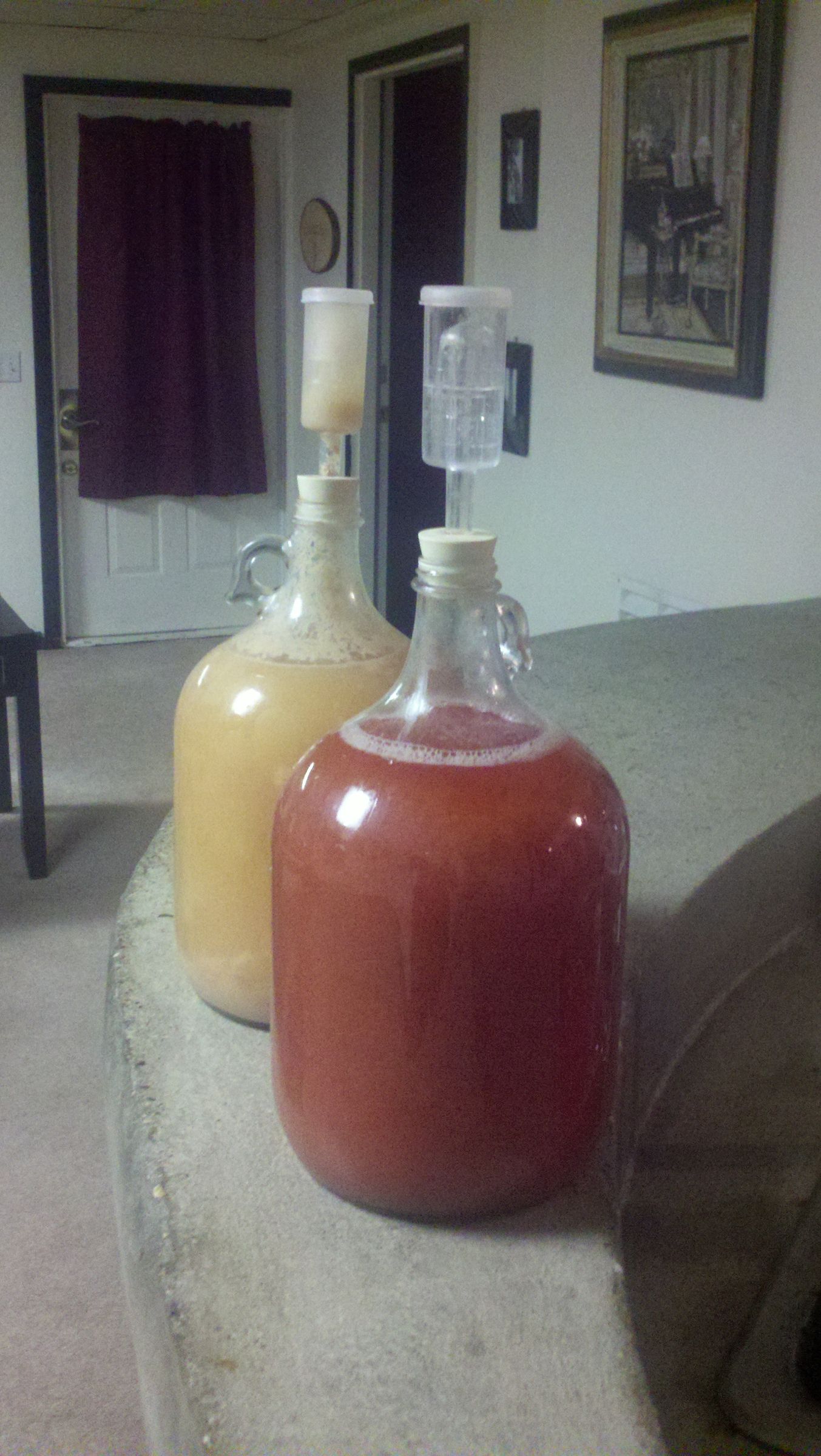

Step 7: The Waiting Game
Once the raspberries have lost their color, rack off them and the lees. Take a gravity reading. If it's at the ABV% you want it to be, I'd recommend adding some Super Kleer http://www.midwestsupplies.com/super-kleer-kc-finings.html, and storing it in a cool place (or fridge, if you have room). After a few days, it should clear up beautifully. You can rack it off the lees again and get ready to bottle. While you're waiting, make up some cool labels. I used http://www.myownlabels.com/.
If you've lost quite a bit of volume from the rackings, you can add more water. I've done this with every batch without issue. In fact it's even helped with some off-flavors. But you need to be careful not to add too much. It will dilute the potency and flavors.
